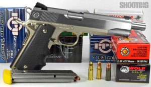

https://www.shootingtimes.com/editorial/converting-a-1911-to-7-62x25-tokarev/99440
Converting a 1911 to 7.62x25 TokarevThe 7.62x25 Tokarev is longer than the usual semi-automatic rounds for American handguns. The maximum length of the 7.62x25 Tokarev is 1.386 inches (35.20mm). That's 0.106 inches longer than the .38 Super's 1.280 inches. This additional length poses a problem because a 1911 frame and magazine are not designed for a cartridge as long as the Tokarev and this limits how many rounds will fit in a .38 Super magazine. One of my 10-round Chip McCormick .38 Super magazines would only accept four rounds of the Tokarevs, while another magazine would only accept five rounds.
