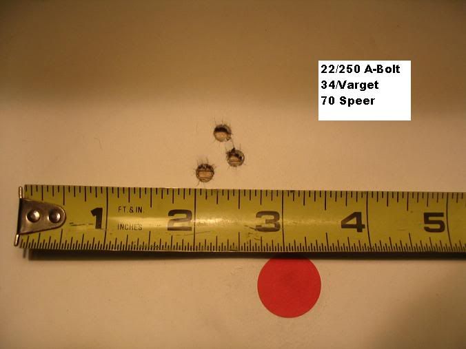

Here is a 3/4" , 3 shot group, out of a stock, 1:14" twist, A-Bolt 22/250 using 70gr Speers.
That Speer is a bit shorter given its semi-spitzer and will stabilize better than a longer bullet.

Right - especially because (in Alberta at least) the smallest big game rifle permitted is .23 caliber. And I'm surprised Supercub could get those 70 gr speers to stabilize in a 1:14 twist barrel. I would have thought you would need something up around 1:10 or 1:9.
Here's another, much smaller group! :eek:
These bullets shoot well because they are shorter than full spitzer bullets.
