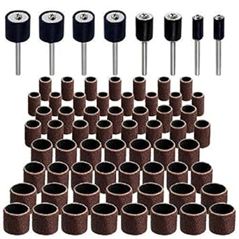

Gently just buff only the sharp edges that have the potential to injure with fine 3-M roloc scotchbrite pads in a die grinder. You should be able to polish without cutting through the chrome.
