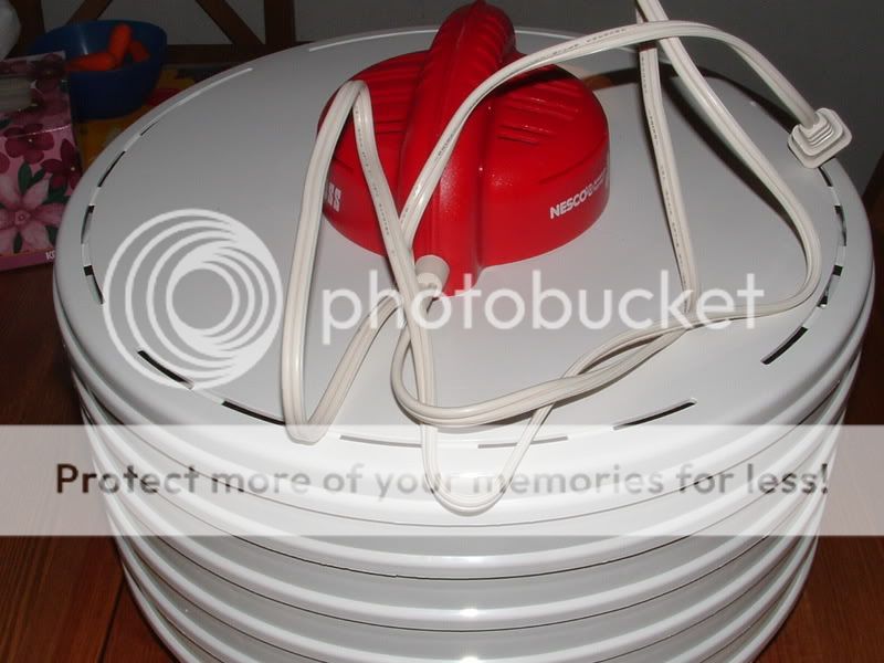

The Nesco is what I bought from Walmart. I'm fairly happy with it although I have noted that it generally takes a little more time for things to dry than what they say. Also, despite their wonderful vortex or open flow system or whatever it is, I still have to rotate the racks once or twice to ensure an even dry.

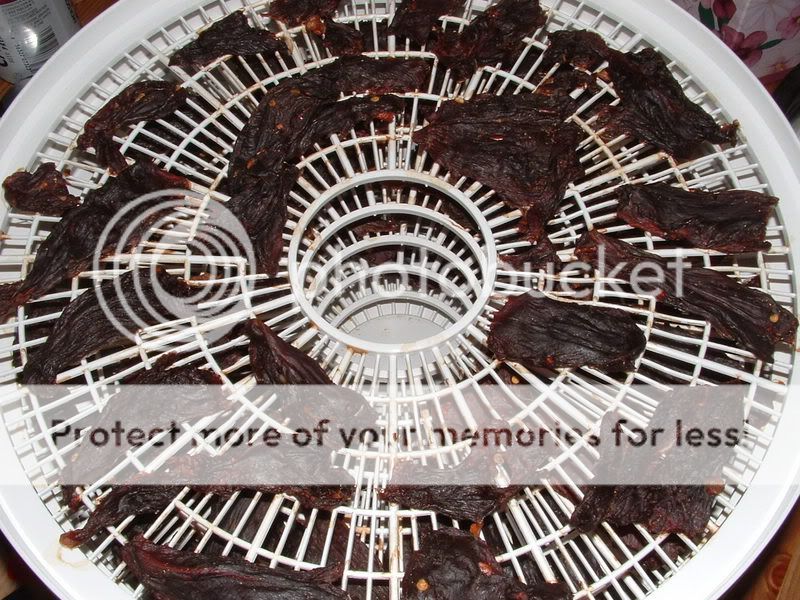

Here is my Nesco with deer jerky.

I bought my Nesco dehydrator at Sears. It was only available in the Sears catalogue. You are able to have up to 12 trays wich great when drying lots of meat. The additional tray's can be ordered when ordering the dehydrator.
The sears Model is slightly different than the one available at walmart.I beleive they recommend a maximum of 7 tray's for the one sold at Walmart. It is a few extra $$$ for the model sold at Sears but was well worth it for me.

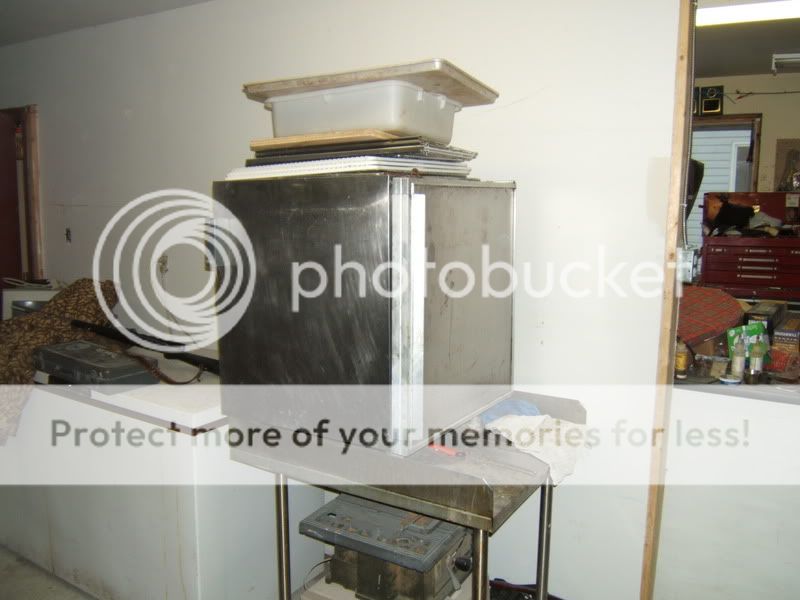

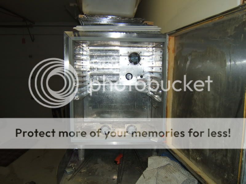

I built my own out of a under counter freezer
I pulled out all the guts coils' condenser, and such
but I kept the defrost element as the heater
And used a remote thermostat
It works like gang busters:)
here is some pics
I installed the stainless steel shelf brackets and used grates out of old fridges cut down to fit
I also have SS rods that I hang fish on to dry:)
I used old 110V computer fans for circulation
