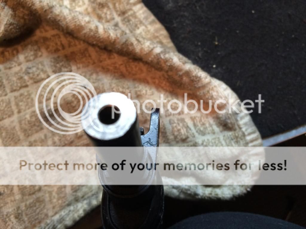

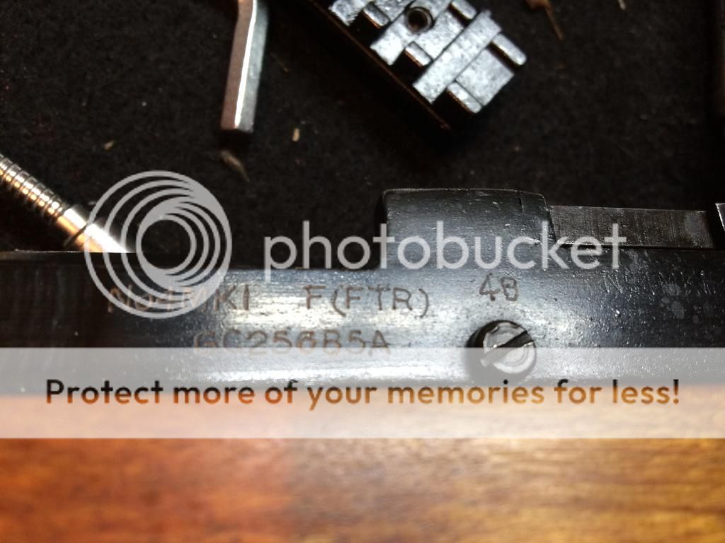

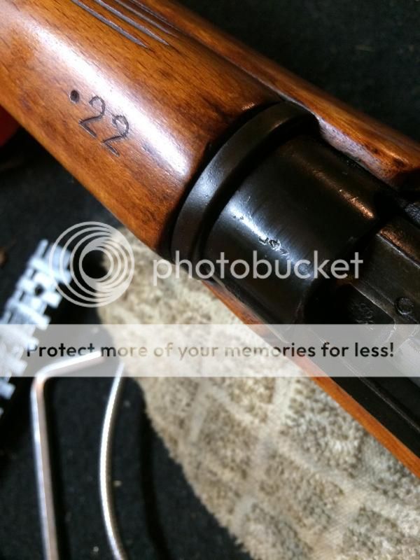

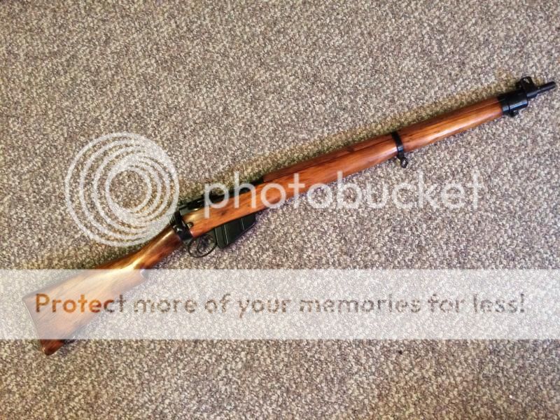

not wanting to hijack but .....I wonder if it was the Calgary armourer guy who created this sleeved .22 , its all matching including the magazine . I haven't been able to find any info on it .
