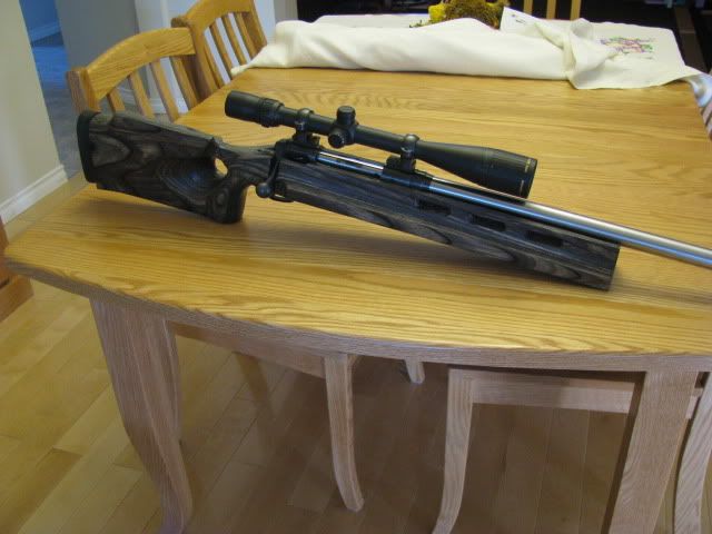

Or you can use a Savage center feed mag and push your bullets out to almost 3" OAL for a short action.
Here is a pic of my test target for my new Shilen 260AI barrel. The Savage action is mag fed.
Read all the details here
http://www.mysticprecision.com/htm/rifle.php#barrels2
