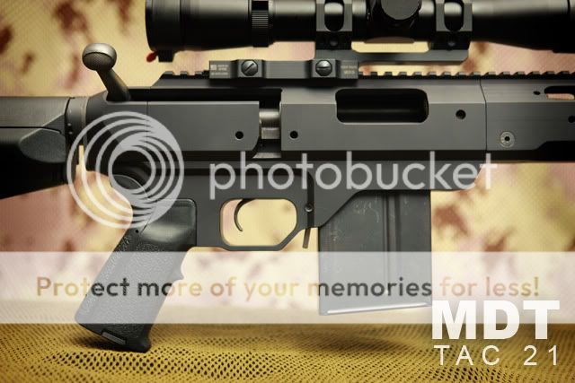

MDT Chassis - Much like the AICS, but has different ergo.
