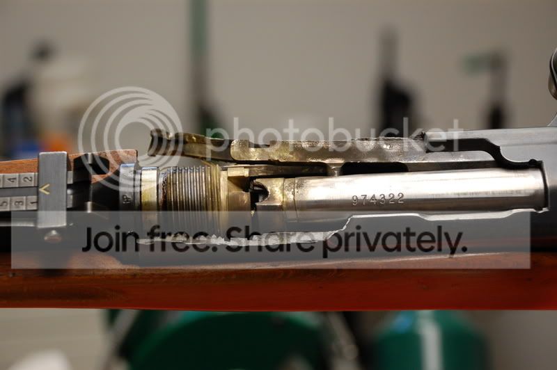

17 thou is nothing, not for new brass anyway, should be able to handle that easy....and that starting load would not have been 60,000psi.
Something else going on there.
Pretty much every Nork M14 out there is running 15-20+ thou over 308 specs and there are probably millions of rounds through those combined. Steel cased don't seem to handle it so well however.
The case head looks very thin in the pics, and I don't see any signs of brass flow anywhere, just the case coming apart.
When the max SAAMI headspace range is .004" then .017" is a huge variance. You are going to need to back up your claims that Chinese M14 copies are routinely running wildly excess headspace cause I don't believe it for a second.
The SAAMI dimensions exist for a reason and grossly exceeding them will eventually result in ruptured cases. When it happened to me, I got through a bunch of cases before one blew but even going in I knew they chance that this would occur. It was simply an eventuality.
I fully believe SEE can occur but it is very difficult to induce. Separated cases from excess headspace on the other hand are extremely easy to induce. Occam's Razor at work.
