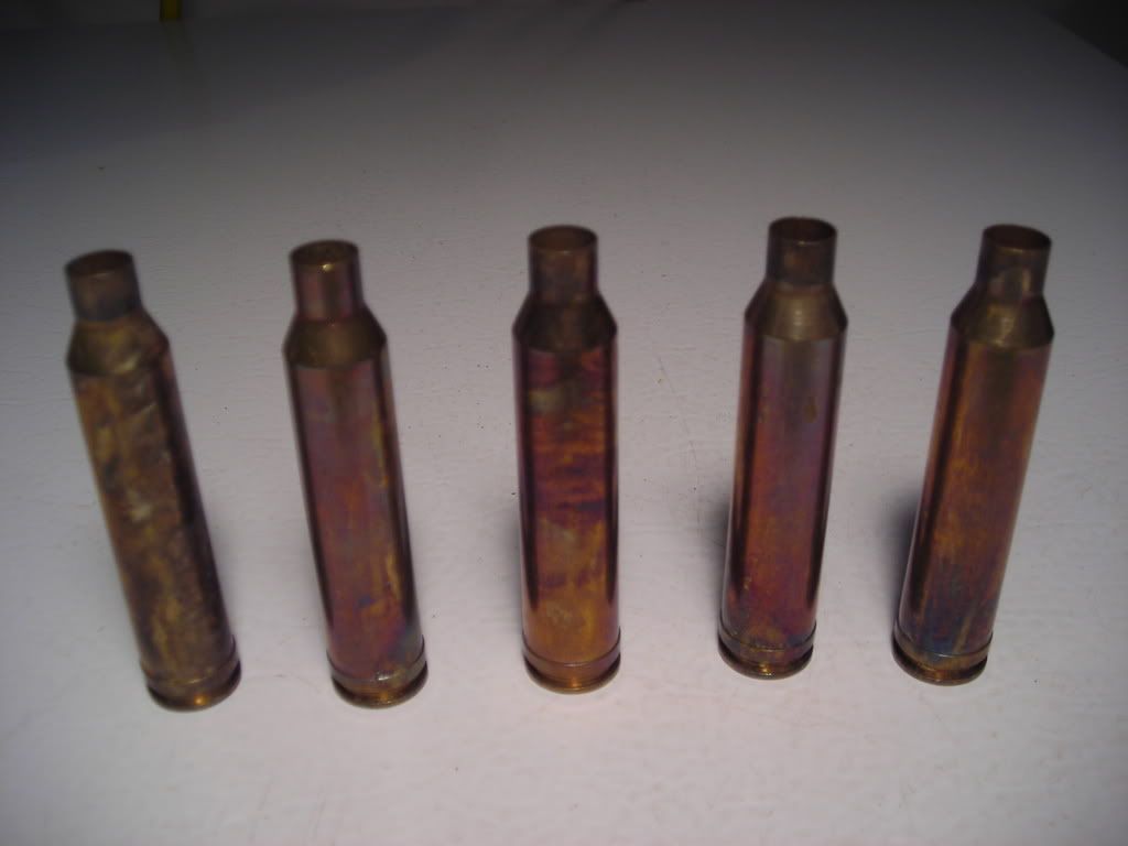

Ok so i deprimed and washed about 100 cases. Then I put them in the oven to dry since it was already on at 400. They spent about 30 minutes in the oven.
some of them are a little darker, some have taken on a reddish tinge. i would think that 400 is a little low to have annealed them. but i want to make sure before loading and shooting these
should i just toss these or will a good scrub with steel wool suffice?

I'd bet they are fine, the reddish tinge could just be the residue from whatever you cleaned with. I've seen it before on cases I oven dried and they were fine. 400 is a little hot though. I'd keep it around 150. I once let some boil dry by accident and they were fine even after sitting in red hot pot for a few minutes.
EDIT - after seeing your pics, I'd toss em
Cheers
the colour changes a lot with the angle and intensity of light. this was pretty much a worse case scenario with no flash
i'm not arguing. i just wanted to clarify. with normal room lighting most just look dull

Heat one up with a torch and cool it, then push the side of the neck against a hard corner - like a tool box. You will immediately notice how soft it is. Now try one of your Betty Crocker cases and see if it is anywhere near as soft.
Baking extremely clean cases may discolour them before softening.
Okay - So I just went to the workshop and experimented with cases.
The discolouration such as yours show, happens early on in the heating process and I was able to duplicate it before annealing temperatures were reached.
When annealling a neck in air - with no pan of water, the case head turned that colour.
When annealing normally, one would likely pass that temp without even noticing it.
I remember some old ( military?) brass that was discoloured like that ( 6.5 -55 maybe?) part way down the cases.
If the necks are mushy soft, thats too bad, but if not, I would load up a handfull and watch for loosening primers.
