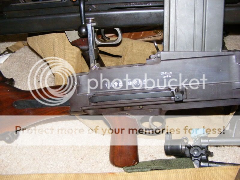

I have a 8mm Bren, with Chinese script. But it is Inglis marked. The book "Bren Gun Sage" makes no reference to LB Brens. although it does make mention of LB being involved in certain endurance tests such as the 30 cal Bren conversion.
Heres a shot of mine taken with my new camera. Finally I can show a picture thats not all fuzzy and shakey, so Cantom can quit buggin me about the (lack of) quality of my photos.
