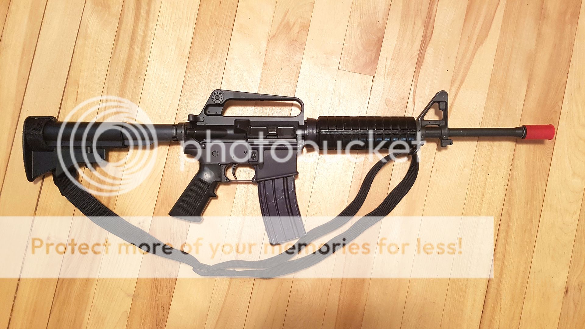

Both my personally built AR's are on Colt Canada lowers. Top notch, and I wouldn't ask for more, especially since one of my builds is a C8.
Sweet rig. Was this built on a stripped lower? Finish looks way darker than the one I bought today. Just trying to figure that part out right now.

Cheers, and yes, built on a stripped lower. Once I got it, I realized what you've noticed, that it's dry and hell. Take CLP and pour it on. It'll soak in and give it another coat (think like oiling dry wood).
It'll darken up with oil.
