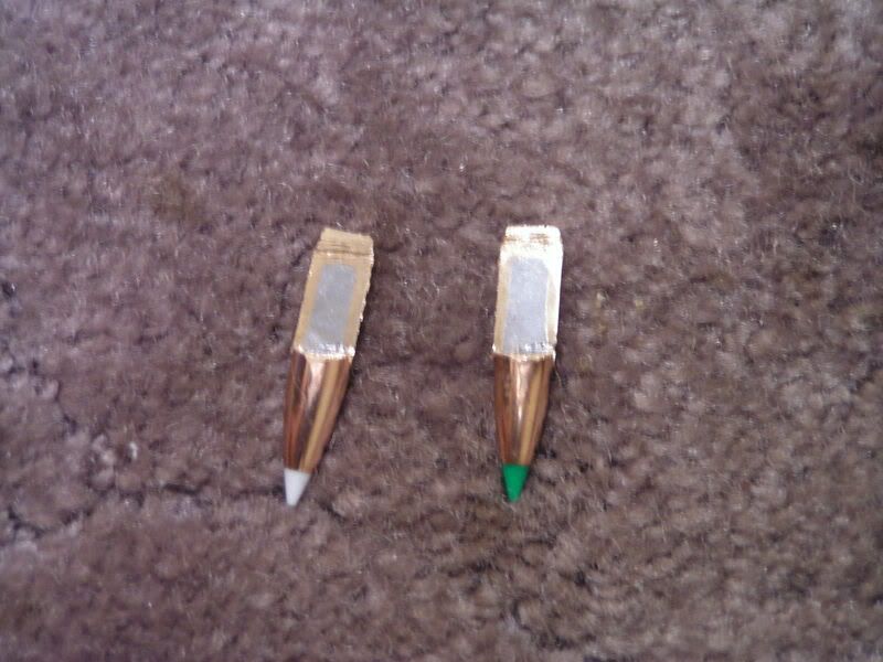

Examine the two sectioned bullets below, identical caliber and weight, but one is a Ballistic Tip, and the other an Accubond. The jacket thicknesses are identical as close as I can measure them.
Can't quite tell from the pic but it looks like the BT's jacket thins out at the ogive where the AB stays thicker right up to the tip. Neat picture!

I have sectioned them to the tip, but this time I left the colored tips in place for identification. The jackets look identical from tip to base.

Many original Ballistic Tip bullets did have quite thin jackets. The "Varmint" versions still have thin jackets.
When Nosler brought out the "Hunting" BT's, the jacket thickness was increased to match the Accubond.
Additionally, even the original ballistic tips in certain weights and diameters always had a thicker jacket [.308/180; .323/180; 338/200; etc]
I have a few "original" Ballistic Tips in .277/140. In comparing them to some .277/140 Accubonds, the AB is a bit longer than the BT, indicating
the jacket on the AB is more copper, thus lighter. This means the bullet gets longer in a given weight/diameter. Sectioning them verifies this.
Like Stubble, I often section bullets. It gives a bit of a picture of construction, and likely it's performance as well.
