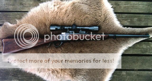

As differences are mainly cosmetic there is no reason why one design should shoot better than the other, but I was a little concerned over the forend band contacting the barrel so modified things a bit.
Overall I'd say the #3 was designed to be made a little more cheaply, but the action is just as slick and the wood quite satisfactory.
I just finnish putting a recoil pad for a customer on a Ruger #3, very light and nice handling rifle, the fellow put an Ruger #1 rear stock on it, looks and handles much better than the 2X4 stocks they come with!Dale Z!
Why not?
Thanks, Ted. It was sitting in the used gun rack looking terribly sad, I could barely make out the grain. The barrel band was missing so rather than replace it I had a gunsmith friend do the Alexander Henry thing with the forend to keep with the general Ruger theme.
Amazing what some fine sandpaper and a few coats of tung oil can do for a nice piece of wood.
