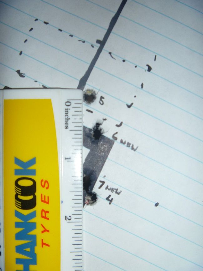

Bit of an update to this thread,
I just got in from shooting the super x ammo, ive almost done the first box still Effin around with the rifle, pulled stock off an put er back together after a clean an inspection an put some rounds on target...
I also tested the Question i asked to a degree, i shot the 2 boxes of super x i had at the same target an both hit where they were suppose to, incl my shooter error.
interesting.
still left the federals out, with the wins i got around 1.5 moa which i fine.
cheers
WL
