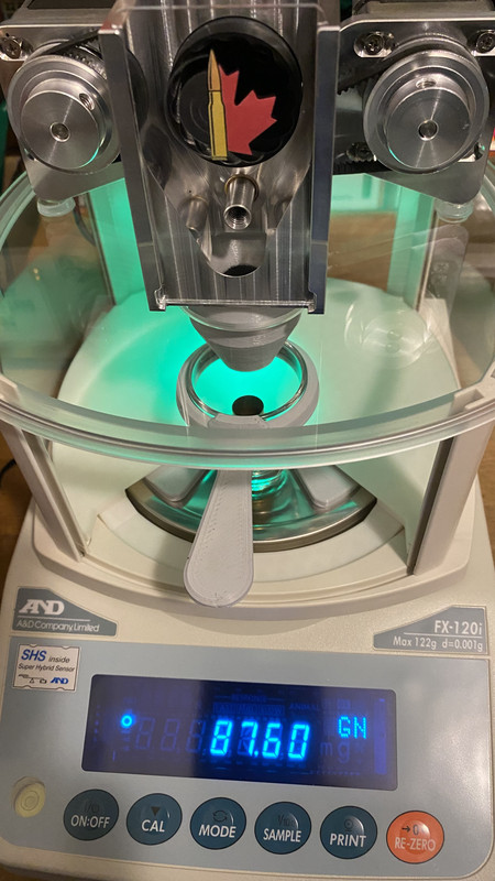

Agreed! a good beam scale will never let you down, In pursuit of getting accuracy I took a plunge down this rabbit hole with digital scales and powder dispensers, so far the most accurate scale I've gotten was with the new RCBS Charge Master Supreme that can hold accuracy between 1 to 3 kernel weight variance with N555 tested on my beam scale.
Here is a few things that I found that can effect scale accuracy
1: unclean AC power can cause digital scale to drift and I've seen this happen with one of my scales, until I started using a line conditioner and it made a big difference with the drifting problem. I'm using my old $800 Panamax that was used in one of my home theater setups. Little overkill but it's being used instead of sitting in a box.
2:Un-level surfaces can effect readings.
3:Air movement in the room from AC/Heating systems
3:Changes in room temperature.
4: Surface stabilization and isolation, more so with highend analytical balance scales.
5: This could just be an old wife's tale but some have mentioned that fluorescent lights if to close to the scale can cause problems, Not sure It's true or not! however all my lighting is LED in my reloading room.
I should have my A&D FX120i soon so I can run more tests with loads. Here's some photo's of my setup.
