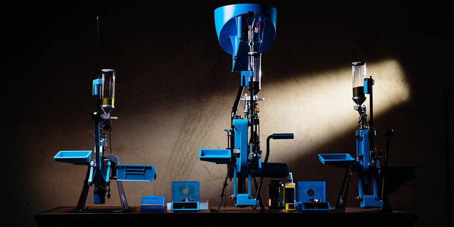

Dillon Precision Products - Now Available!
Western Metal Inc
Rating - 98.6%
72   1   0
Calgary
Come checkout our new Dillon Precision products listings!
We have presses, kits, parts, accessories, and much more! You can filter by brand on our website to see all the Dillon Products we offer.
https://www.westernmetal.ca/shooting/
