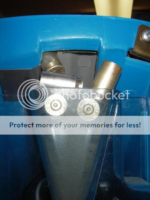

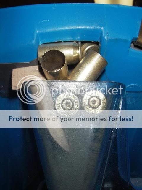

I'm still having casefeeder feed problems, but, for now, I'm a convert to case lube on a progressive press!
