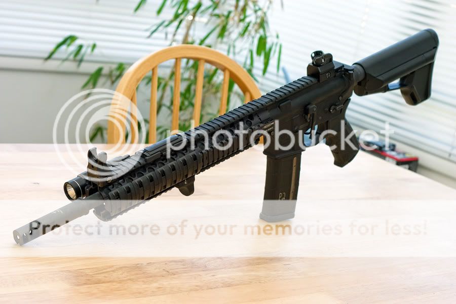

Centurion Arms makes drum sights for the AR15.
The AR belongs to someone in WA who works in a gun shop/indoor range.
Lower
LMT 2-Stage Complete Lower
Magpul ACS Stock
Magpul MIAD Grip
Magpul BAD Lever
BAD A.S.S Safety Lever (Normal left, Hybrid right)
Upper
CMT Upper
LMT F/A BCG (Standard)
BCM Gunfighter Mod4 Charging Handle
Centurion Arms 16" Midlength barrel
Surefire MB556AR Brake
Centurion Arms 12" Rail
Centurion Arms HK Diopter Sights
KAC Handstop
Streamlight TLR-1 w/tapeswitch
Magpul XTM and Ladder rail covers

The "drum" type sights are patterned after the H&K sight. Simple and sturdy.
