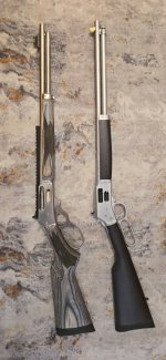

My Marlin sbl 30-30 came with stunning sights. Much nicer than my skinner I put on my Henry 1000058969.jpg

My Marlin sbl 30-30 came with stunning sights. Much nicer than my skinner I put on my Henry View attachment 892027
Thanks, eco. Same sights came on the 357.
