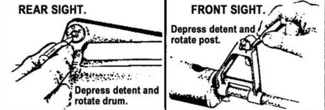

I've seen the US Army training film that suggests using the tip of a live round to rotate that wheel with the detentes in it. It ain't that easy!
I gave up on it cos it looked like a dog's breakfast was about to occur.

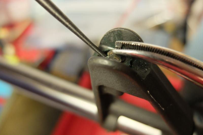

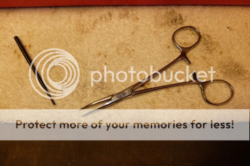

I found an easy way to adjust the sight post. I took the drift that was included in my (ahem) ex-Soviet Mosin-Nagant's cleaning kit
and used it to depress the retaining pin, then grabbed hold of the flats on the sight post with an old hemostat I often use as a mini locktite
needle nose. I was then able to relax and spin that sight base like a carousel.
An original solution to a vexing problem? I expect others have discovered similar methods; there may even be an aftermarket tool available that works better.
Anything would be better than trying to use a live round! Sheesh. f:P:2:
The tools:
The operation:

WRH-- No, no marring. Once the pin goes down, then the post spins and, the way the hemostat locks, it does not slip.
Question for you, sir: After you've depressed the pin with your allen key, how do you turn the post? By hand?
I can't get my banana-sized fingers to grasp the post--that's why I'm using the hemostat.
