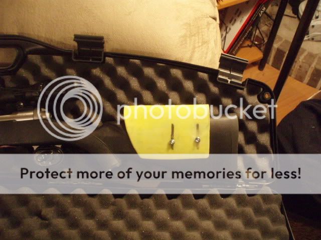

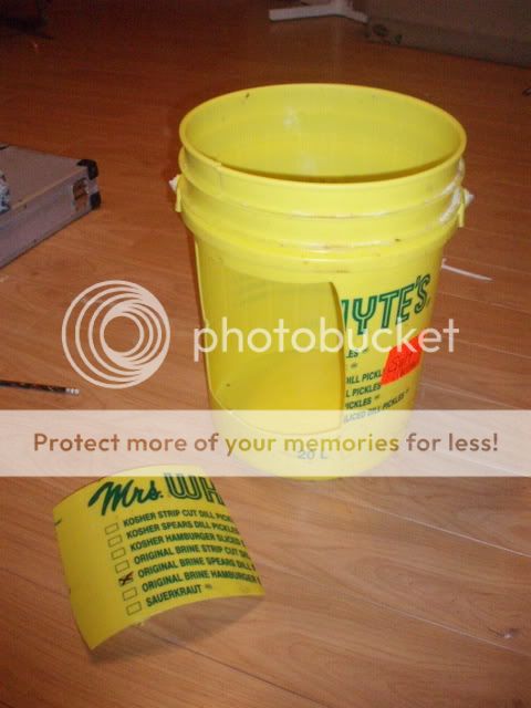

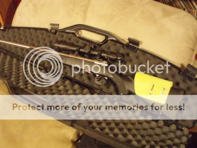

I had been putting off doing this until tonight. I'm sure there are a lot of different ways to do this, the method I chose probably wasn't the easiest... What was once a plastic pickle tub is now my surprisingly effective cheek rest. I'll post up some more pictures once I make it more visually appealing. Anyone else have a DIY job they'd like to share?
You might be a redneck....sorry, I couldn't resist. Seriously though, the plastic in that barrel will likely become brittle in the cold. Watch it doesn't greak or shatter on you. I can't say I really care for the color either. It does nothing for the nice black contrasting stock to your fancy polished action. The nuts and bolts add that "Bubba" flair to it too, but at least they match the finish on the rifle.......Just my humble opinion though. Guess as long as it works for you, and you don't mind the looks, it's good to go....:runaway:
I was thinking about making the same type of set up using fiberglass. I just hate the thought of drilling 2 holes through my laminate stock. I have some heavy (1/4") rubber gasket material here, I was thinking about making a glass one and putting the rubber inside and just slipping it over the stock. I'm not sure how well it would stay still. I should be able to make it so you have to spread it a bit to get it over the stock thus nipping it a little once it's on. I may try it later this week.
Hahaha this CERTAINLY isn't the finished product, think of it as a rough cut. I plan on forming the plastic more and painting it matte black. It won't look as slick as a Rooster33 but it cost me $0 haha. I did consider how brittle the plastic might get in the cold because this is only a temp until I have the money for an entirely new stock in the spring. Luckily I use the same kinds of buckets for hauling compost around the yard. They had been outside since last spring, and yesterday morning (-15) I went outside and kicked one around for a while, couldn't crack it.

I'm a student, which doesn't mean that I don't have $15-$20 to make one with new materials, but I'd rather spend nothing right now and save that money to put towards a complete stock in the spring when I can work full-time. Overall I'm really pleased with the results. It doesn't look store bought but it will certainly suit my need for this season. Here is the finished cheek rest.
The finished results look pretty good...nice job! As long as it works, who the heck cares about the bolts through the stock? Not every gun in the cabinet has to be a safe queen. :)
