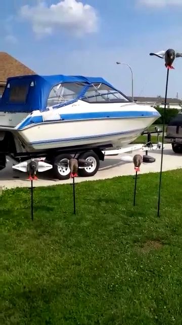

Heres a video of them in action with me turning them all on and off,

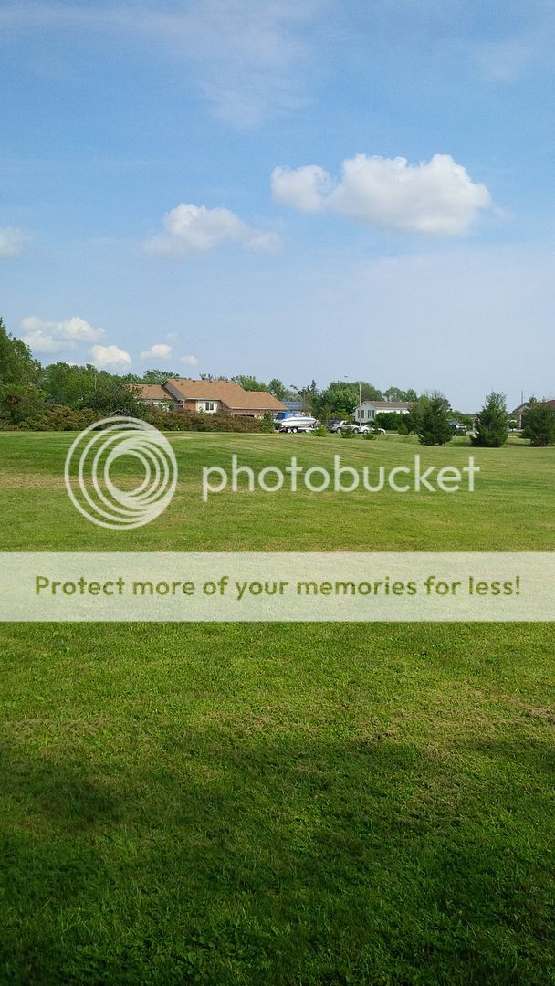

Heres a picture from 115 yards away and both remotes ran all 4 decoys perfectly.
All of these decoys are running on 4 AA batteries for a total of 6 volts in the decoy and this doesnt seem to be a problem so until we see it being an issue, we wont be replacing the 4 AA battery pack with rechargeable 6 volt batteries.
