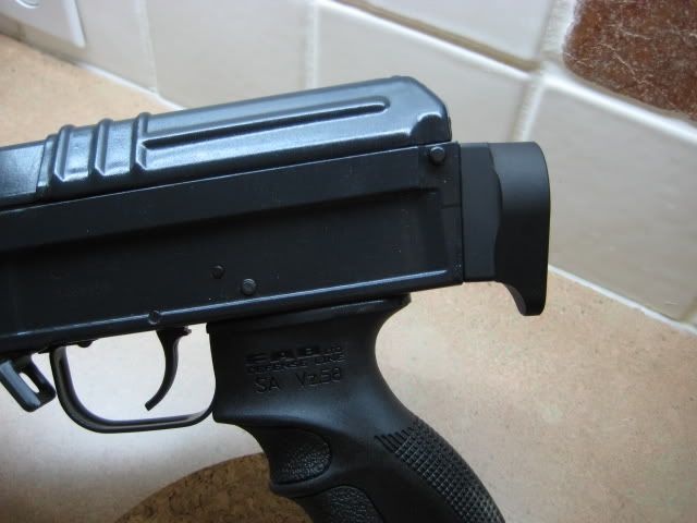

I finally managed to shed the last piece of ugly furniture on my CZ-858 and install my AR-Stock I've had lying around thanks to this sweet little adapter made by Dlask!
This is the same item that VZ58.net will be selling.
The finish and fit are excellent. I was very impressed with the fit - it's tight (in a good way)!
Anyway... picture time:

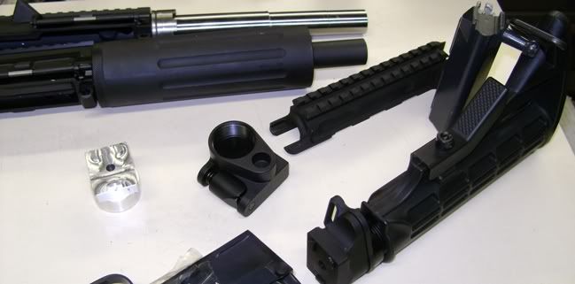

There is a folder in the works right now (for CAR stocks).
Last details are not decided yet,
but it is possible to look like the one in the center of the image here:
The top retaining slot: US Vz.58 receivers are not split across the top, back, side like that. They are contiguous, and smooth, with only a female screw hole in the back of the reciever. This wouldn't work on US VZ's.
US Receivers do not have that cut-out in them. Do all Canadian VZ's have that?
I have 2 US Vz's in front of me and both look just like in the pic.
Yes, all Canadian VZ's do have that (to my knowledge). Interesting that the US ones do not. I'd too like to know how the cover stays in place.
Anyway, the knub could be filed flat easily to fit :)
