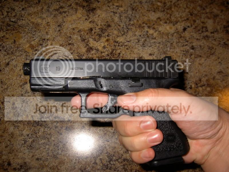

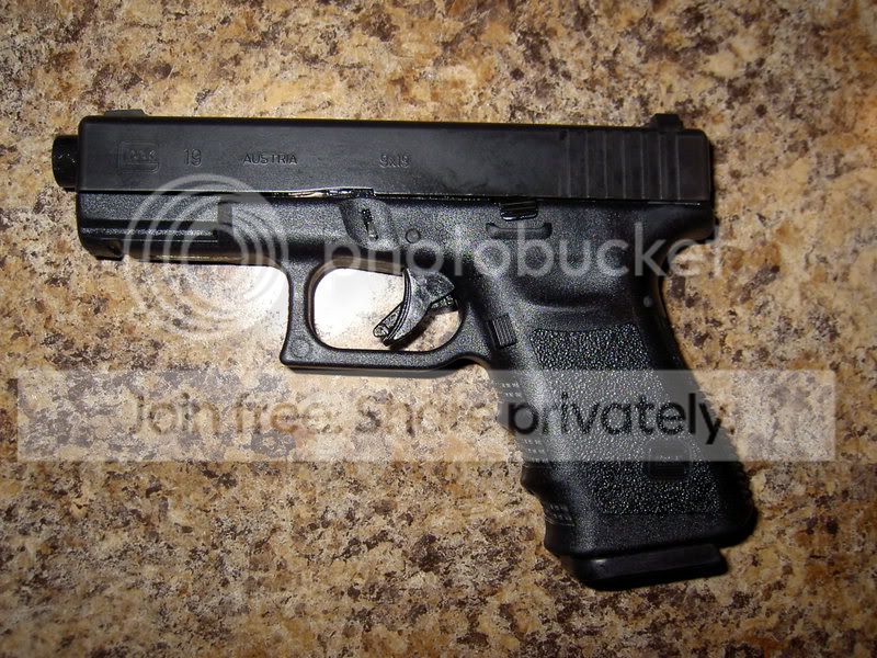

Dlask Glock G19 with Pic
Nice. :)

Well Boys - took her to the range tody. It was pissing rain:mad:. First shot went bang then nothing :confused: and slide locked up tighter than a bankers wallet...not sure quite what happened cause I couldn't rack it....I think I may have not allowed the trigger to reset. I slapped the back of the slide hard and then racked it and that seemed to work....is this common?
Anyway, after that the gun worked 100% through 100 rounds. Quite a bit more muzzle flip than I am used to but after the first mag I found it to be a non-issue. POA was a little bit high and to the right, will have to play with the sights a little on the next session. Even though it has an NY trigger I didn't find it to be excessively heavy, I think I'll keep it as it is.
Overall impression - I like the G19 a lot, points naturally and fits my hand, can't wait to get some more trigger time in.
