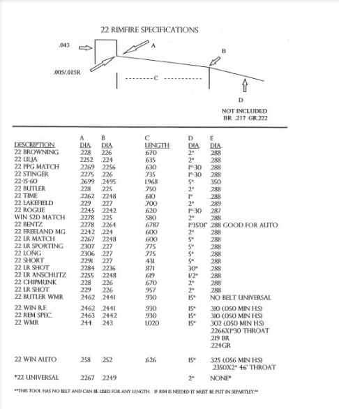

When a 10/22 has a chamber other than a SAAMI sporting chamber, there's a good chance it's a Bentz chamber. This chamber is designed for semi-auto .22LR. It is shorter than the standard SAAMI chamber. (See the chart below for a comparison.)
As a result, the longer Stinger will often not chamber. Many manufacturers of rimfire rifles with chambers other than SAAMI sporting chambers will recommend shooters not to use ammo such as Stingers.
