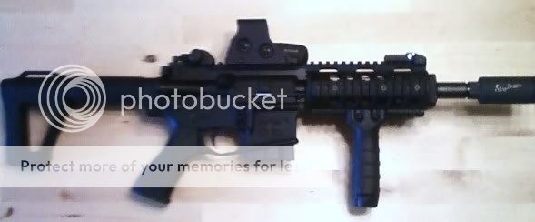

I recently picked up a Dlask Mini moose in new, unfired condition on the EE.
Here's how its set up now.
8.5" BBL
Dlask's version of a monolithic upper
DAR701 lower
ACE SOCOM Stock
Noveske KX3 Flash hider
LAR-15 10 rd mags
EOTECH
Cheap ebay BUIS
Tango down grips front and rear

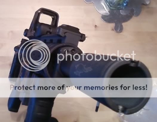

The first thing I noticed about this gun is the weight. For a short little thing, 27" OAL, it feels like it weighs about 8 lbs! It is definately heavier than a standard A2, 20 inch AR. But I have always wanted a shorty like this.
After much drooling and a little tinkering, I took it to the range got the eotech zeroed, and proceeded to shoot some groups. I shot it just like it is in the pics. No, my nose doesnt hit the cocking handle.
My standing groups at 50m were as expected. 2-4 inches, depending on how fast I went with it.
Then I sat down and used the fore grip like a monopod. I shot a 0.5" group of 3 shots! I know its nothing astronomical, but I find it pretty damn satisfying.
I had no stoppages, no problems at all. And the best part is.....
That Noveske is awesome! I had resigned myself to suffering the abuse a short barrel would normally give. Nope, not with this thing. It is as gentle on the ears as a full 20 inch barrel. Even the other guys at the range didnt mind it, as opposed to some of the brakes I have tried on ARs. This is, without a doubt, the best of all the muzzle brakes or flash hiders I have ever tried on an AR. (Although I couldnt tell you what the flash is like at night.)

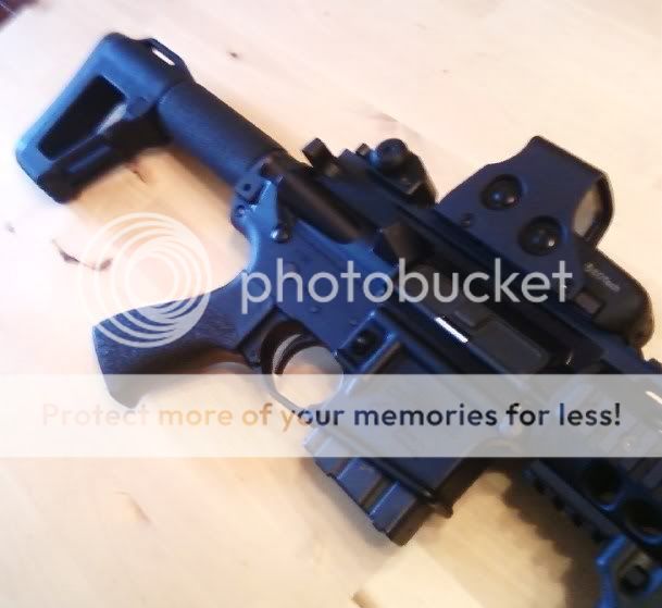

I was thinking that I should say something about the ACE stock too.
Its the short version. 7.5 to 9.5" LOP. The foam on it is tough, not like the handles on the exercise bike in the corner that just holds clothes now. Its quite solid and comes with a sling swivel that can be mounted on either side of the cuff that locks the extension tube to the lower. It also comes with a very soft squishy rubber butt pad. I may take it off though as it is maybe a bit too sticky for my liking.
The one weakness I see in this stock is that it is designed to be used as a bludgeon if you need to, but its just clamped in position with a single allen screw through the cuff the sling swivel attaches to. If I were to hit something hard enough at a bit of an angle, I think the stock, and the whole buffer tube with it might rotate. Now the extension tube unscrewing itself a bit is a helluva a lot better than the tube bending and completely disabling the gun, but my inner worry wort thinks I will have to keep an eye on it. If It seems to be finding a way to loosen off over time I will put a little purple locktite to it. This is the absolute weakest locktite you can get, unlike the green stuff that I used on my boss's new metal water bottle last week. (HAHAHAH!!!)
This is my first ACE stock, (Got it from Fabrice at Fabsports). Should be a good product. Time will tell.
