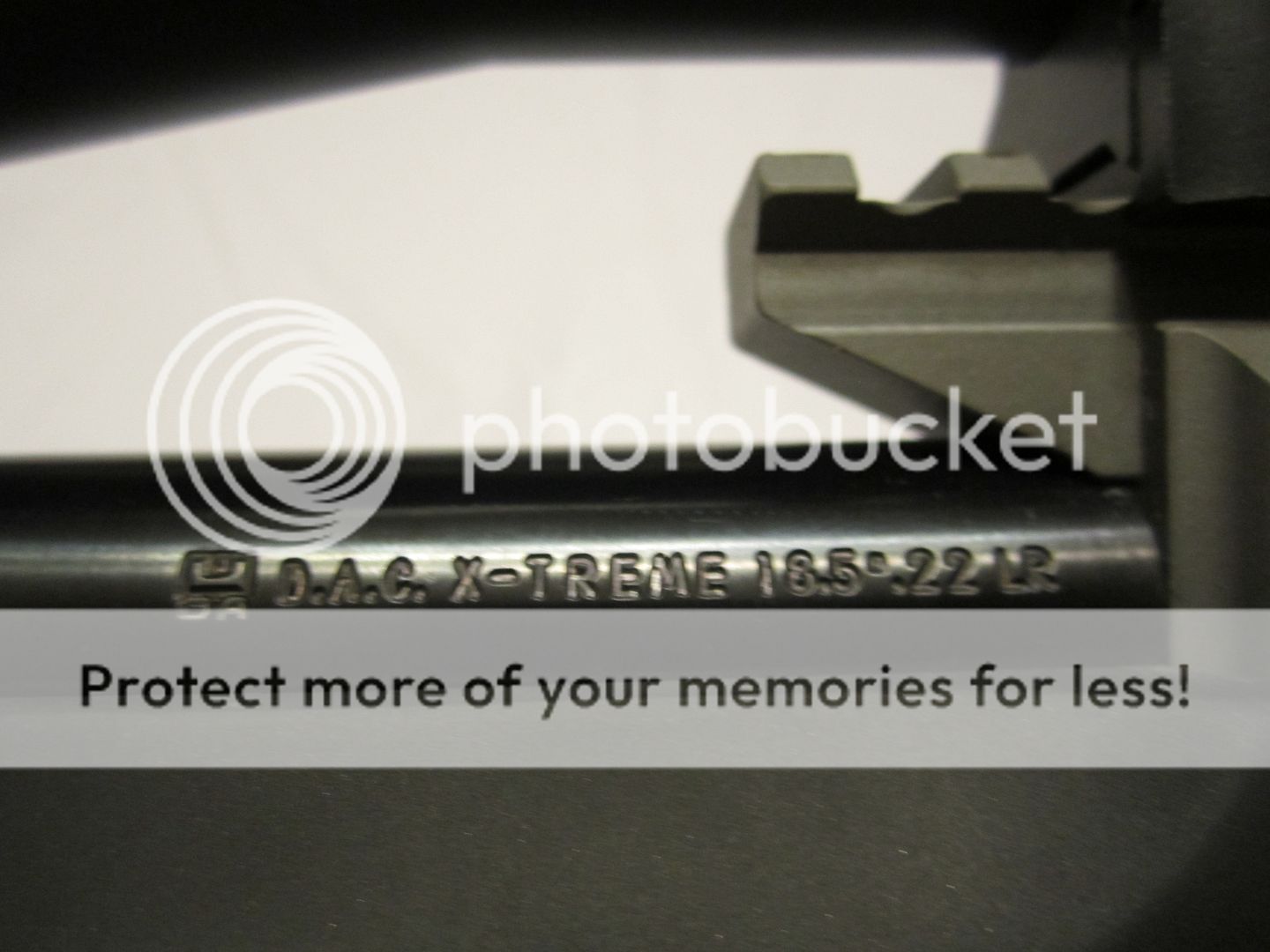

like stated above id imagine you have a X-treme barrel which has the Bentz Chambering which is way tighter then the normal ones.
have a look at your barrel and see if you can find X-Terem or Sporter on it.
or push a round up into it and extract it and see if you can see rifling markings on the lead.

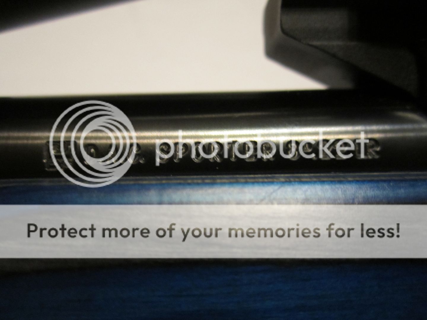

if you are running a sporter barrel and there are no markings on your lead after you do the push in test then your looking at a extractor and firing pin problem.

think i have a pic of my barrel to show you what to look for.
