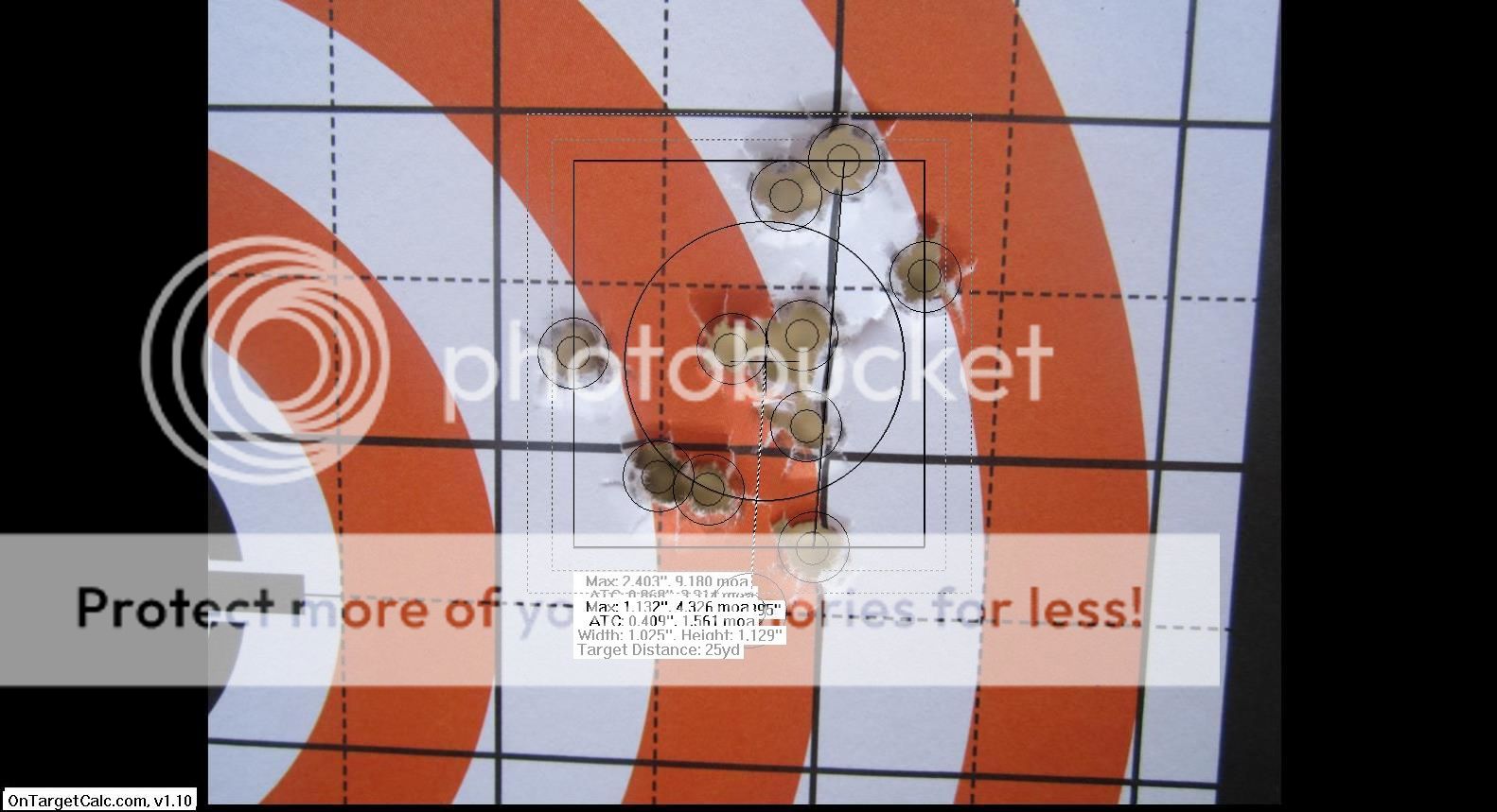

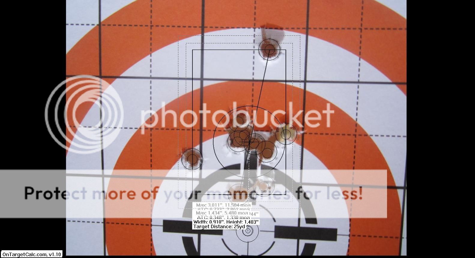

had a chance to go test this today.
didnt notice any difference between having it on and off the gun.
with it on on had a 10 shot group of 1.434" and with it off group 1.132"
im sure if you took off that one flyer off the 'on' group it would make it exactly the same.
but looking at the pictures it looks to me like with the comp on the grouping is better.
might just be my mind playing tricks though.
was shooting at 25m (82ft) with Blazer FMJ with a custom made Dlask rig (on far left)
on
off
