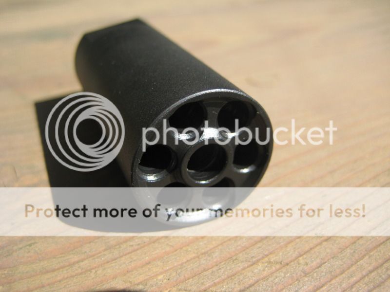

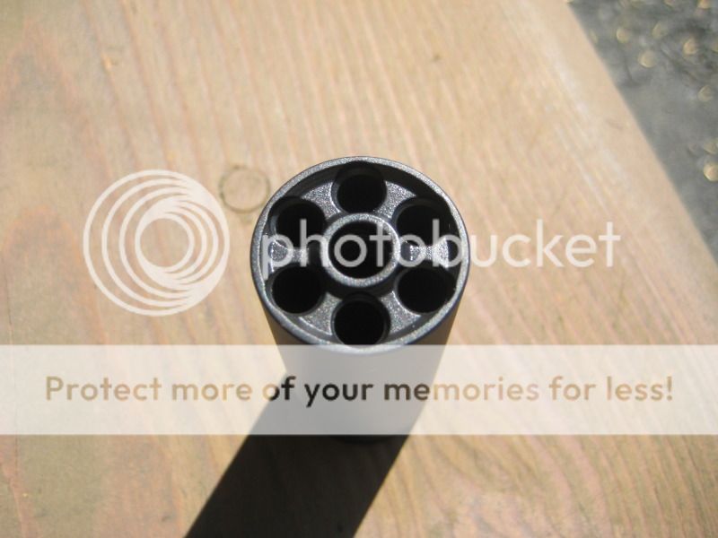

I love muzzle devices, comps, brakes and flash hiders. I'm fascinated by them, so when Dlask came out with their new XB5, I couldn't wait to test it. It looks similar to the Levang linear compensator but it's internal and external construction is quite different. It's designed to force gas and blast forward, away from the shooter.

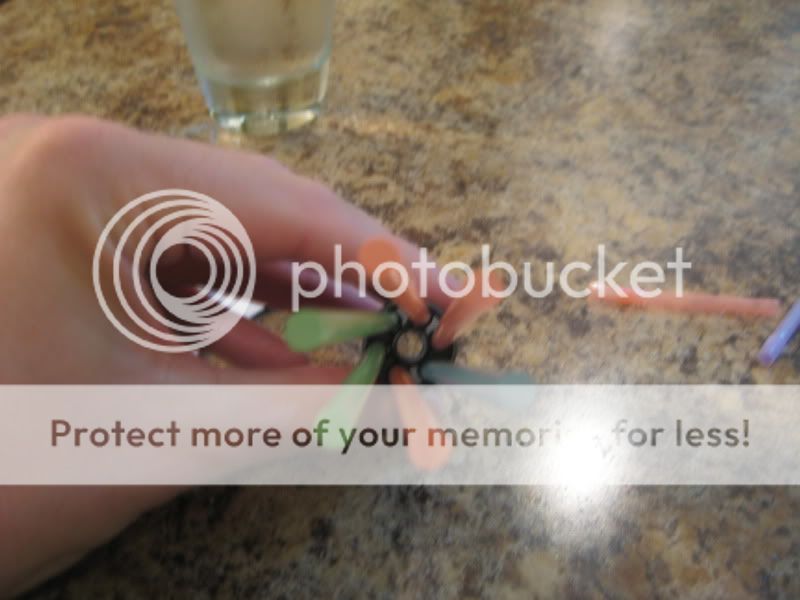

It's internal structure is very cool! (Sorry I'm a geek for this stuff, can't help it:redface:). They made the six ports slightly angled, to create a kind of rotation of the ports around the bore. It's so slight I almost didn't notice it so I stuck some straws in there to illustrate it:
I've never seen this done on a muzzle device before and it's cool because, in theory, it should more efficiently strip gas away from the bullet as it leaves the muzzle. This should help stabilize the bullet during flight and improve accuracy. They also recessed the muzzle which also helps create a preferential flow of gas away from the path of the bullet.
I really wanted to save this device for a 22lr target rifle I have coming but it looked so friggen cool I had to try it on my AR. Here are some more pics and a video:

That swirl effect must put some kind of torque onto the rifle. Is the swirl rotating in the same direction as the projectile or against it?
To be honest I didn't notice any difference in torque when shooting some drills, but it's a good question to ask. The ports are kinda oriented in the same direction as the rotation of the projectile (I think), and more importantly same direction as the gas flow.
