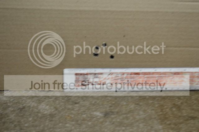

So, yup, it's 6 weeks later (don't ask) and I finally got my new Speer hand loads down range. If this pic upload works it shows my progress. I do have a straggler in my five shot group but I've got 4 all together here. Looks promising to me. 100yds. 168 gr Speer bthp 44.5 gr of imr 4895.
From that group, I'd say your bedding is fine.
Shoot that load again. The odds are that you pulled the flyer. It's harder than you think to keep all the shots together for five consecutive shots, even with a super-accurate rifle and load.
For whatever it's worth, the classic match combination for decades was something like 41.5 or 42 grains of IMR 4895 behind a 168 Sierra in a .308. That gives moderate velocities but consistent accuracy. If you follow Dan Newberry's 6% rule for OCW loads, reducing your above 44.5-grain load by 6% should land you right between 41.5 and 42 grains. (That principle suggests that reducing an accurate load by 3% gives a crappy load, but reducing it by an additional 3% yields another accurate load -- in other words, accurate [and inaccurate] loads are predictable, like waves on a graph, separated by 6% of powder charge.) This is a long way of saying that you have likely hit the top accuracy node for 4895, so your results are not surprising.
I think you are off to a great start.
