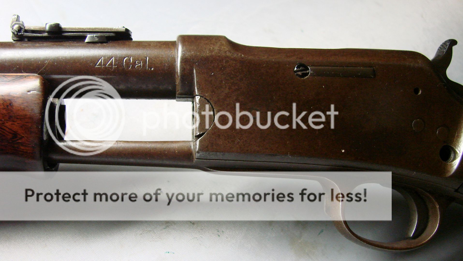

I have a Colt Lightning Medium frame carbine which is missing some parts and I am wondering whether it is worth the effort to try and rebuilt it.
(missing parts) –magazine tube
With springs etc.—extractor, saddle ring.
The stock was damaged and was repaired.
Serial number 6212--.44 cal.
Barrel address;
Colt’s P.T. F.A. MFG. Co Hartford Ct USA + ELLIOT’S Patents May 29 1883
Sept 18 1883.
I don't have recent photos since the stock was repaired....but I can take more if needed.
I don't know much about this carbine.
NOTE;
The action functions very well.
David
Colt barrel address.
Serial number 6212.
More photos to follow.

Thanks for your responses and advice.
I am not sure if I am the right guy to undertake this project.
Based on the serial number 6212 I believe that this carbine was manufactured in 1885.
What is this carbine worth in its current state?
This gun has been sitting in my safe since the late 1970s and I just took it out to take some photos in the past two days.
Here are some more pics.
David

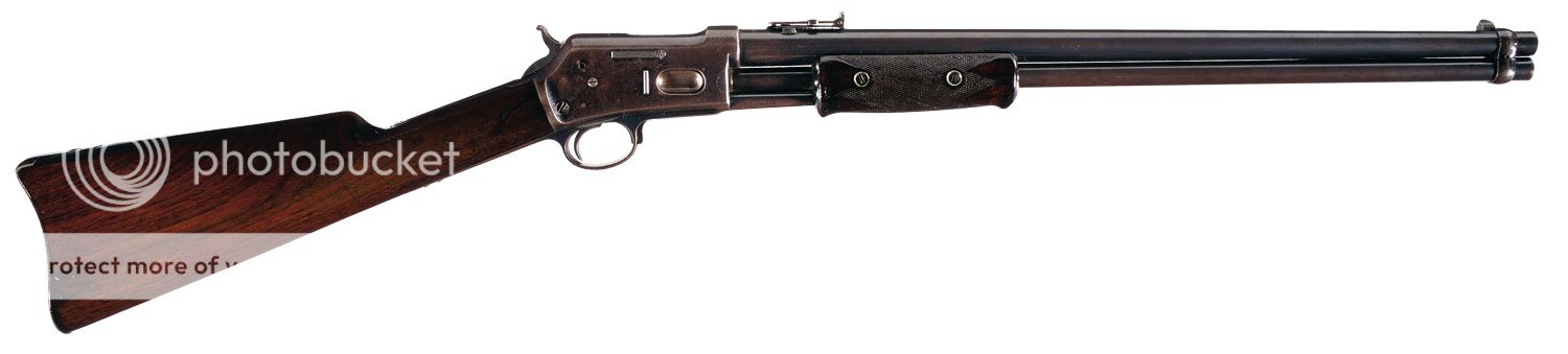

A rather sweet example.
drm3m, that's in pretty good shape, IMO.
If all you are looking for is a mag tube to make it complete, I should think that some digging amongst the used gun parts dealers should come up with what you need, and would be a better thing to do than to build something that simply works.
Then it will be worth more than the sum of its parts, eh?
Nice lookin' gun, I think it would not be a difficult project.
