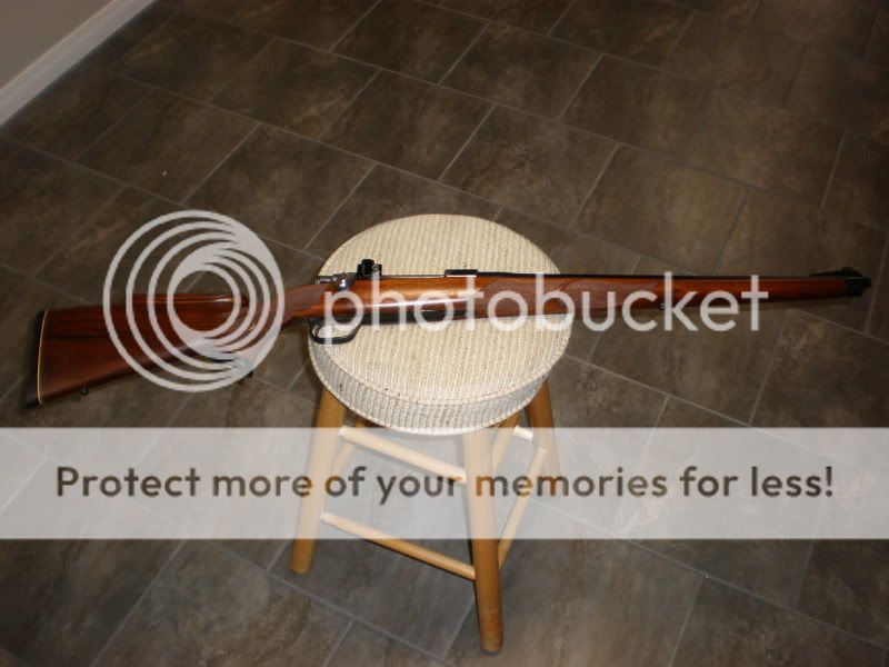

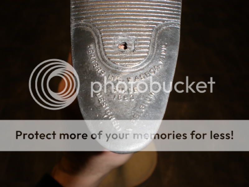

The buttplate states "Herters". Herters was a large mail order (mostly, but they did have several stores) company that provided a lot of sporting equipment under their own name. Everything from Decoys, cookware, tents, camping equipment, books, reloading tools and supplies, guns, and gun parts and accessories to name a small bit of their merchandise.
They imported actions (BSA, Santa Barbara, FN, and others), and had barreled actions an stocks, and also complete rifles.

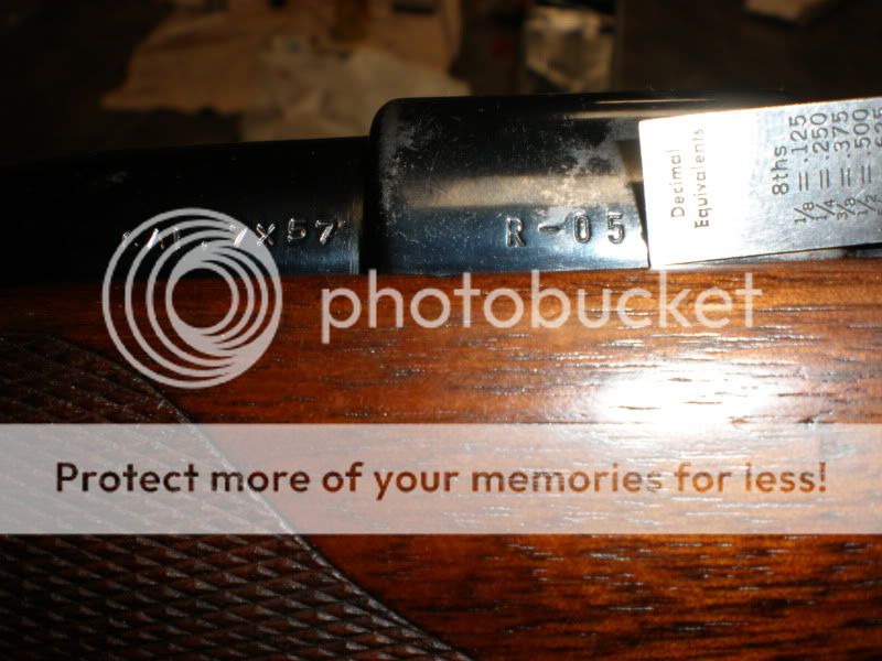

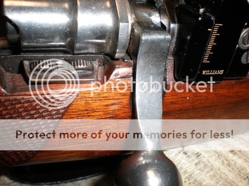

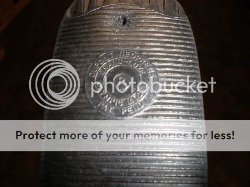

There are a couple of clues here. First of all, as mentioned, there is no thumb cut-out on the left receiver wall. The recoil pad says "Made in Belgium", and the "R" prefix on the serial number may be a model designation for this 98 Mauser action. I do know there was a "J" prefix model, but I do not have an old Herter's catalog handy.
The Calibre stamp, "7x57" is a bit uneven, and that might point to a custom Gunsmith making up this rifle. Herters did supply lots of stocks, including Mannlicher types.
