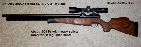

A quality pcp has superb accuracy, the ability to dial in velocities from 600 to 1000 f/s, light and heavy pellet choice and with a 177 a limited range by choice...
