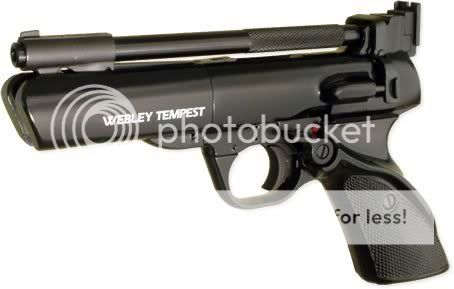

Looks like the manual calls it 420fps but other places it says it's rated "up to 500fps". So I'm not sure what to believe. Since it's a 30 year old gun I would have to say the chances of it shooting over 500fps is quite low. I guess a chrono is the only way to know for sure.
It looks like this, in case that helps.

Beeman USA made the Tempest and Huricane as well under contract. There was a Kit available to replace springs and seals to up the power to well over 500 fps for both the .177 and .22 models. Should your gun have had the replacement seals and spring it could well be over 500fps other wise your looking at 420fps or there abouts.
