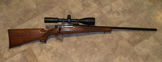

I had a 24" "take off" regular sporter weight .223 Rem barrel from a Rem 700 installed on my Model 7. It originally had the short 18 1/2" pencil barrel barrel on it:
Before:
After:
Groups well with econo Winchester whitebox 45 gr hp's:
NAA.
After:
NAA.
That's an interesting rifle and I really do like the way it looks. I wonder if this is the answer to the recoil. Perhaps a 7mm-08 barrel on the thing would work wonders. Still get a sweet little ultra short action with less recoil and muzzle blast.
How much does the gun weigh with the full length barrel? What's the balance like off-hand?
