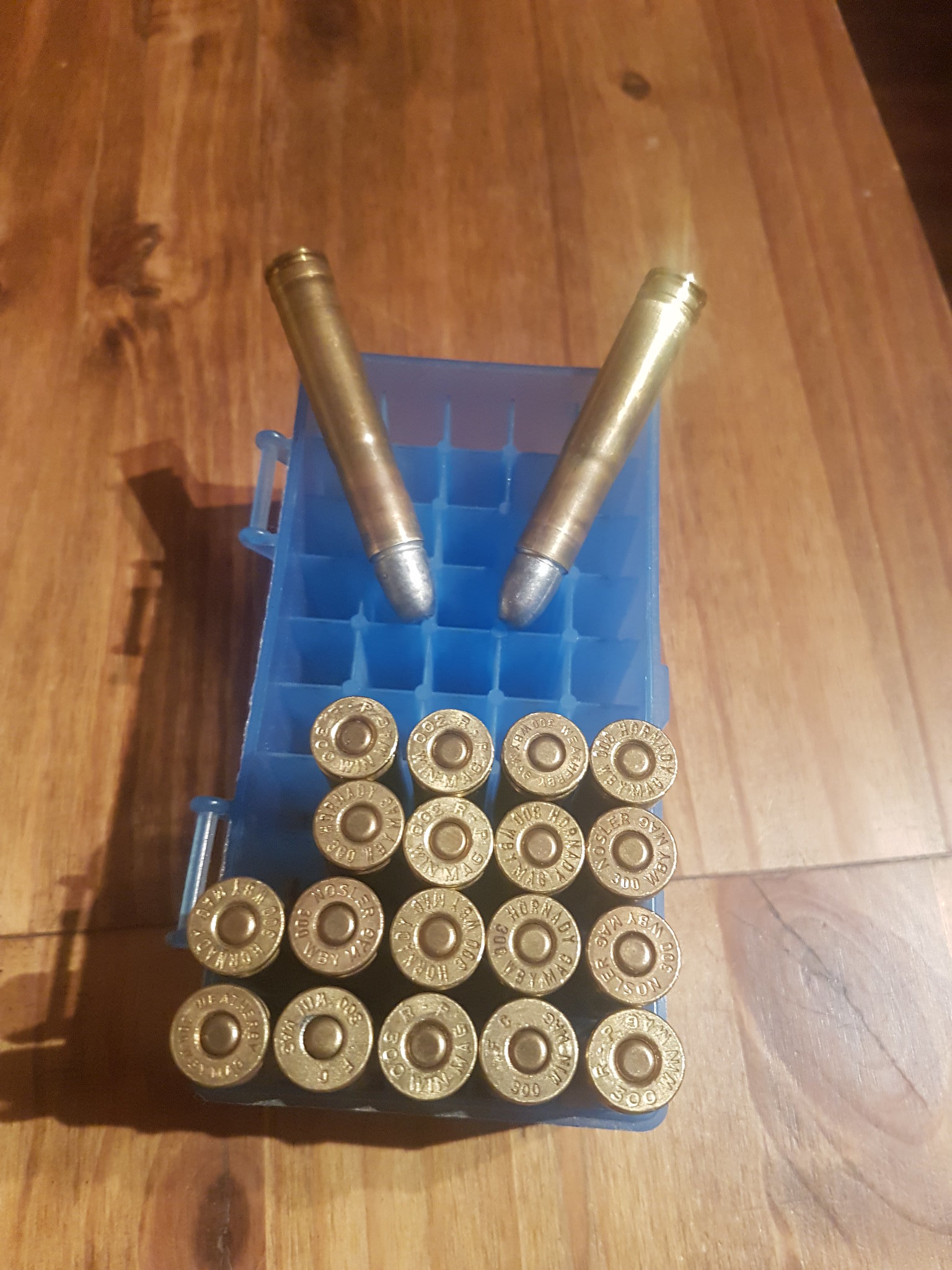

I use plain base cast bullets at 1800fps with no lube in my 43 express. I normally shoot 30 rounds per range session and the bore is always shiny as when i got there.
Here is a pic of 20 loaded rounds i fired off yesterday that has no lube at all on them. Just sized after casting (barrel never got to hot to touch)

Also sorry for the derail. The main point i was trying to make is bullet fitment is the most important thing when it comes to cast bullets. And really they can be 0.004" big with out issue as long as the loaded round can chamber without any effort.
i added a pic of the bullets im speaking of
the left is the 400gr plain base lubed for my 460 i shoot at 2000 fps
and the right is my plan based non lubed 360gr bullets for the 43 express, id size them and load them as is
