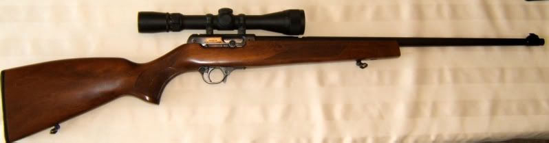

I'm with Reg on this one. Here's a pic of a restocked rifle I bought off of Reg sporting a Weaver 3x9x32AO in a set of Lynx low rings. These are a great little scope, very clear and bright, and can be bought for about $250 Cdn.
Ross
