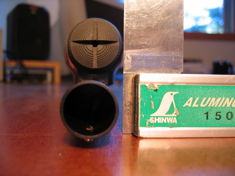

They fit and function but from what Ive seen from 3 different barrels on 3 different receivers they don't index properly. I prefer the Chinese barrels on the Chinese guns.

Mine all looked like this, this gun is resting flat on the milled flat part of the receiver and the barrel lug should be perpendicular to the table top.
