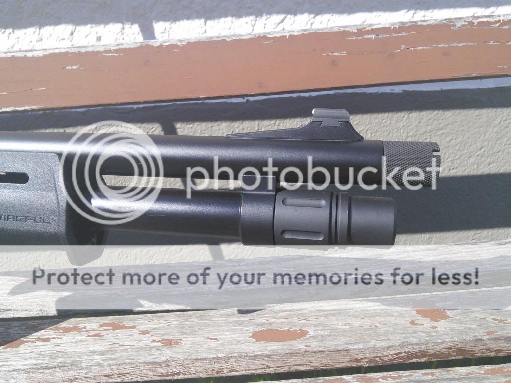

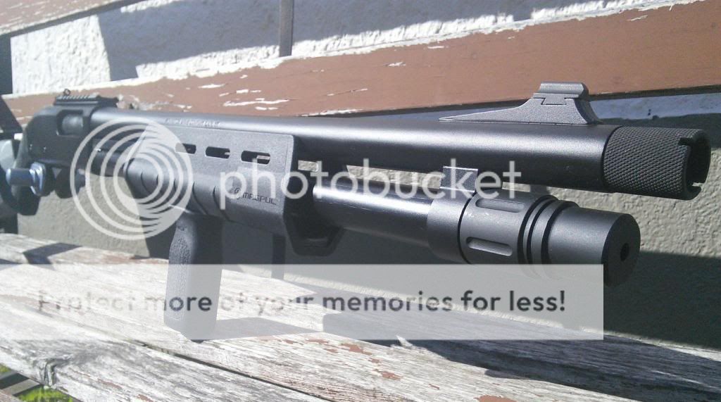

I did my 870 last week.
The dimples were really close to the end of the mag tube, so I was able to just dremel them down then polish them with another bit.
It's a regular 870 Express Magpul edition with an added MOE vertical grip and super full turkey Rem Choke.
I installed an S&J no jam follower and its now 7+1 with the extention.
Yeah, I want to run this gun a little hard and see how it responds. Not looking to baby it. With the foregrip i can really rack the slide hard so that also helps with reducing stubburn extraction/ejection these guns have with elcheapo universal target shells.
Remington's especially this model, get a bad rap lately. I hope this one fares well cause I like it and it shoots good.
