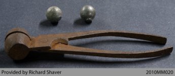

Judging by the condition of an ancient single barrelled shotgun that came down to me, a barn gun, I fear that I must be descended from a long line of screw abusers, but I think most such things are caused by improvisers who will use anything that's to hand to tighten or loosen a screw. And that applies to the tools used too, it was something I had to train myself out of. I remember with particular regret an old musket ball mold I found in the tool box of one of my late grandfathers. It had been overlooked by a couple of generations I'm sure but I recognised it from a movie I'd seen, it looked exactly like the photo below, which is identified online as having been used in 1812. I made some nice lead balls with it but made the mistake of leaving it where others could get their hands on it and the next thing I knew it had been bent out of shape from being used, I'm sure, as an ordinary set of pliers and then it disappeared completely, probably having been broken in two. Why I didn't hide the thing away is strange, maybe, since I valued it and no one else did, but I guess I considered it family property.

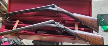

My Westley Richards hammer double had its barrels cut down to 26" at one time.
The barrels however are still regulated well, and it does make a nice fast handling shotgun!
The Westley box lock above it however is a great , unaltered gun, and a fine shooter as well as proofed for smokeless , I also feel very fortunate that I was able to find it on the Intersurplus site!
