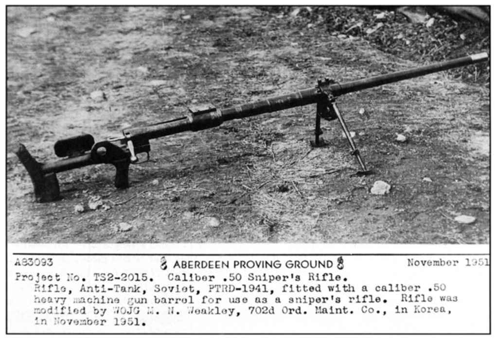

Now, what about the bolt?
Should I get someone to make, and silver solder, a new cup on the bolt face, extractor, and lengthened firing pin.
Most M2 barrels are Stellite lined so impossible to re-cut the chamber in. But at least the outer surfaces could be machined. I think this might have more merit than the DA 50 barrels do simply as they have more material to work with.
