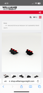

I had a Williams front fiber op site on a marlin I used to own.
Just as good as a scope for the distances I shot
