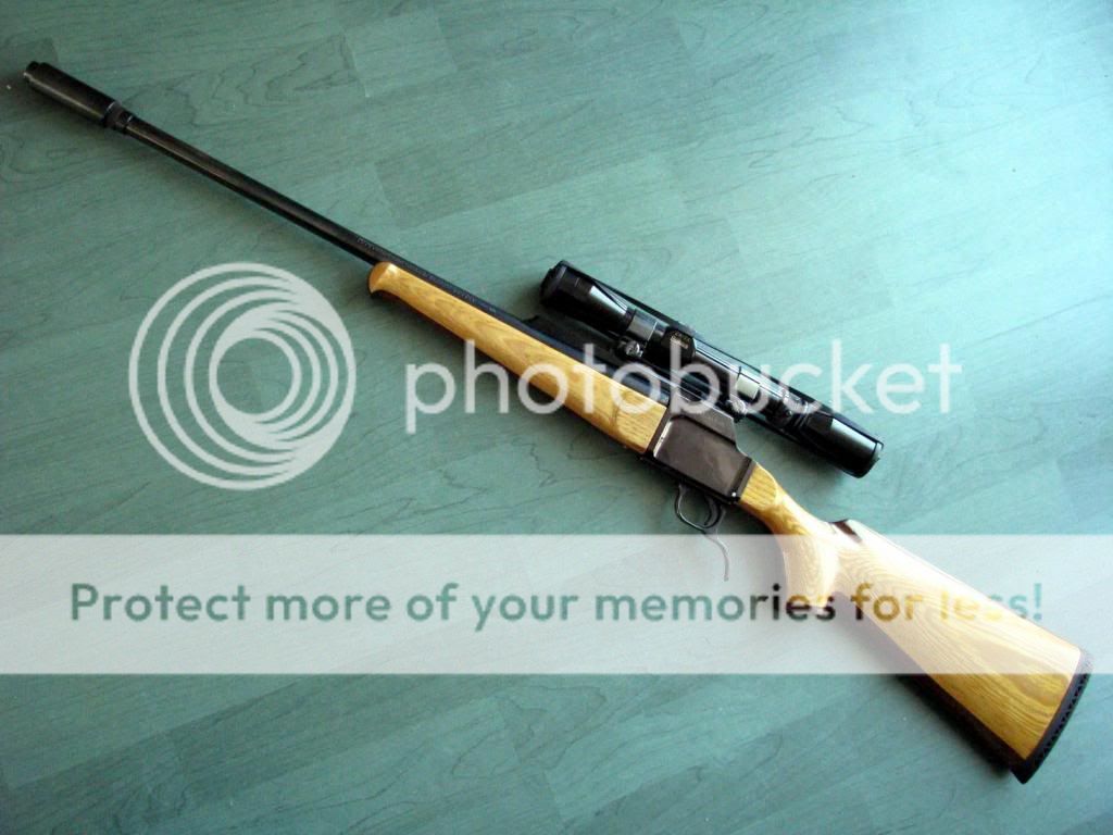

I have built 4 of Frank Dehaas's designs 2 Vault locks 1 in 308 and 1 in 6mm benchrest and 2 0f his Chicopee designs 1 in 30/30 and one in 22rf. All you need is a mill, lathe, band saw, drill press and a lot of time. they all worked out real good and are my most accurate firearms. Here's some pics of the vault locks.
The Vault Lock and the Chicopee rifles can be found in Frank DeHaas' book titled Mr. Single Shot's Book of Rifle Plans. Brownell's used to carry it, may still. The plans were designed to be unlike any other actions out there, rather than copying anything, and were also designed to be made by a guy with a limited selection of tools and a lot of patience.

Nice work on the vault locks!
