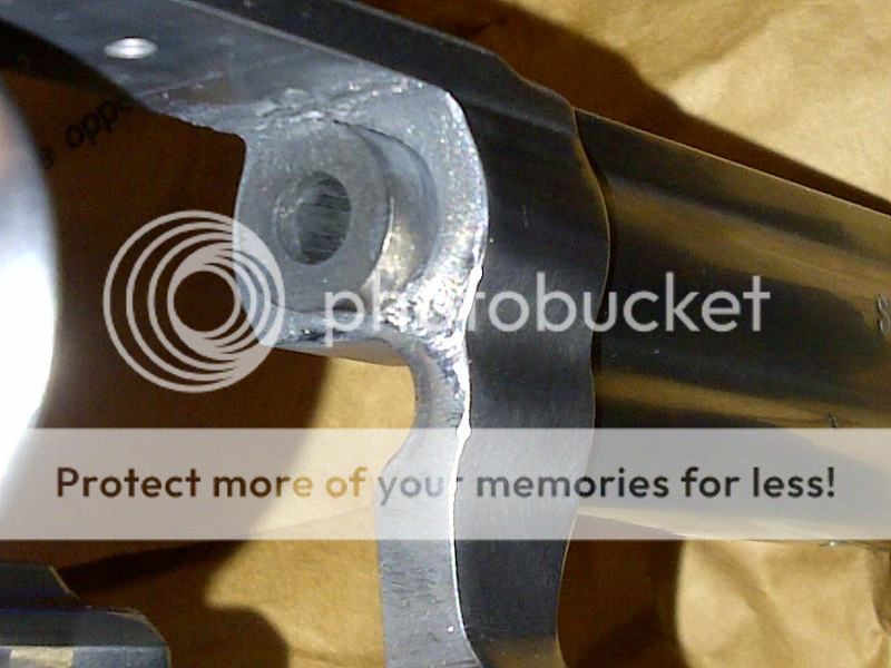

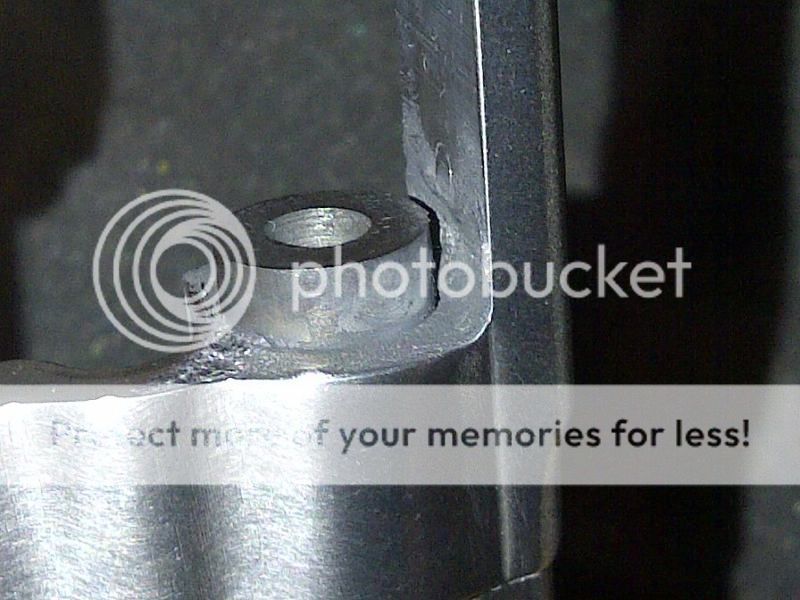

That's one hell of a lot of lead for 200 rds - IME. And no one shoots 200 rds through a .22 and sells it off, unless it's a bummer or he's starving.
Either that or it's a lead shaver.

This is my first .22 revolver, purchased off of the EE from original owner with "approx 200 rounds through".
There seems to be alot of leading on the frame. See pics. Is this normal for a rimfire revolver with an unknown round count or could it indicate a timing issue? The lockup seems solid with no play in the cylinder when cocked.
