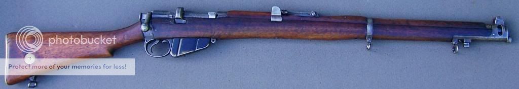

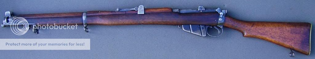

Just for interest sake, here's an old girl in the Knowledge Library. The MKL example includes an installed "Flanders Flap" ...
1917 ShtLE (Short Lee-Enfield) No.1 MkIII*
(Mfg by BSA - Birmingham Small Arms)
In the 1917 example above, note the large dent shown in the side of the forestock in a few of the pics of the photo virtual tour. At first glance it appears to be wood damage from some kind of impact, when in reality, it actually indicates that the stock of this rifle was from old supplies that had already been cut-out, in preparation for installing the front volley sight. By the time this rifle had been manufactured in 1917, the use of front and rear volley sights on No.1 rifles had been discontinued, as of January 1916.
(Click PIC to Enlarge)

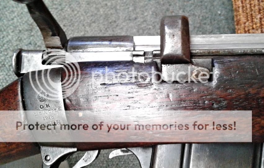

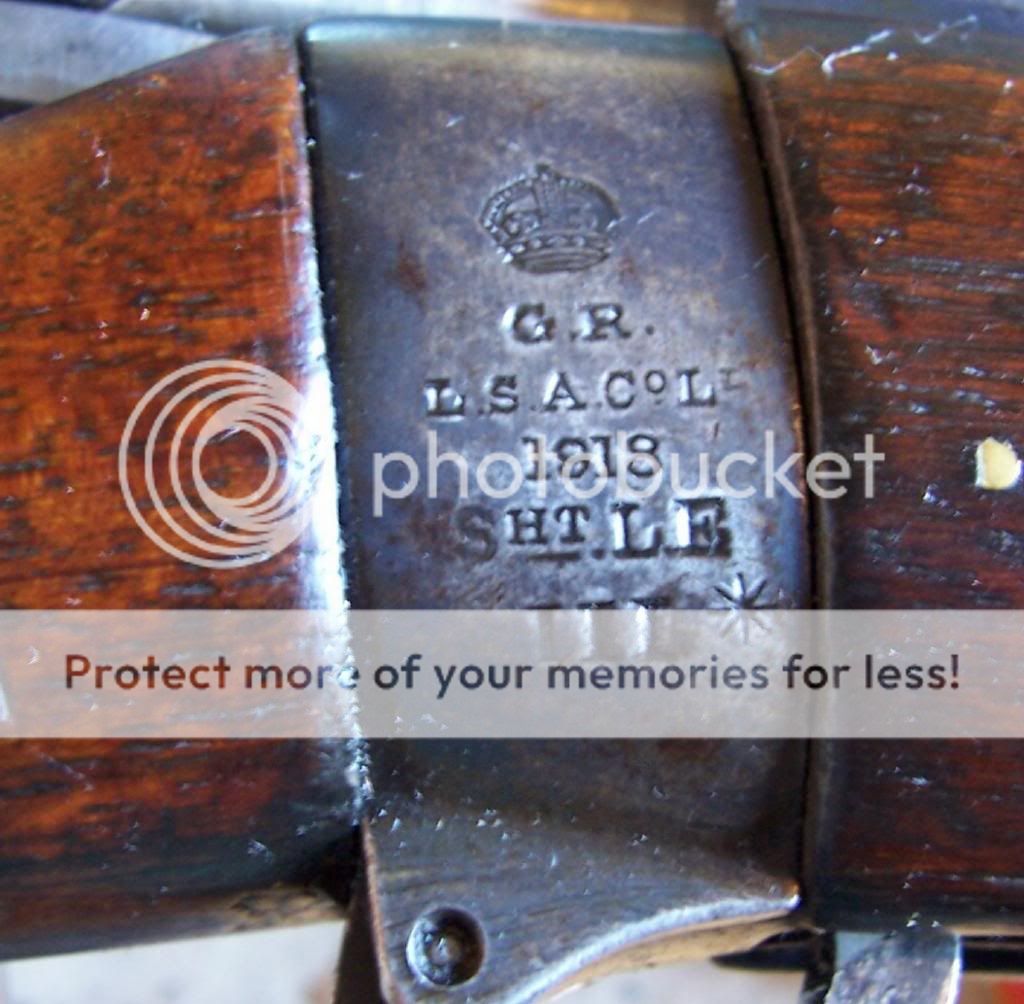

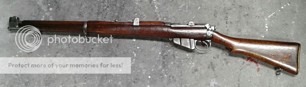

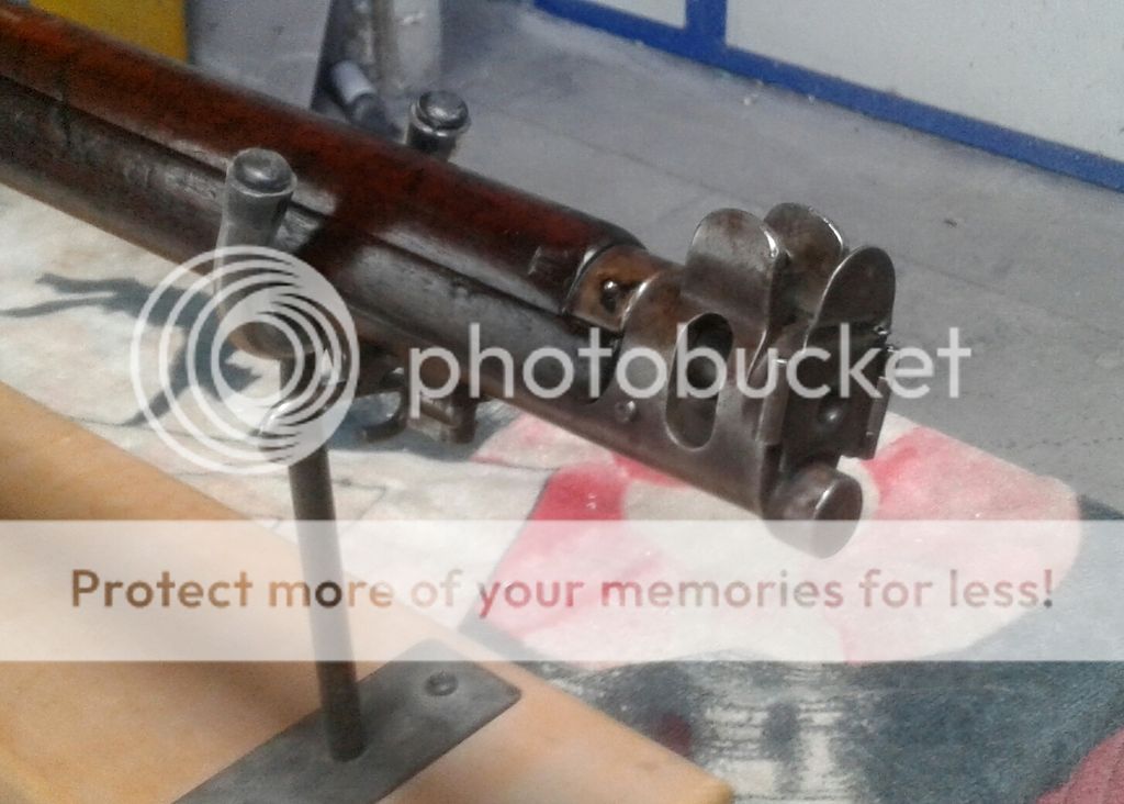

I have stuck my Flanders flap on the 1918 LSA MkIII* i posted before on this thread, rifle has had a few years of BLO added to the wood since the other photo was taken.

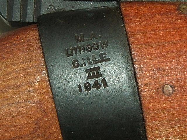

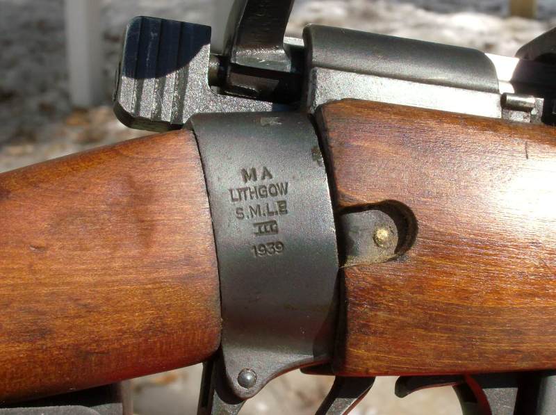

I have a 1940 dated Lithgow SMLE Mk.III no star with mag cutoff fitted but no volley sights. The butt socket markings are the same as these ones -
