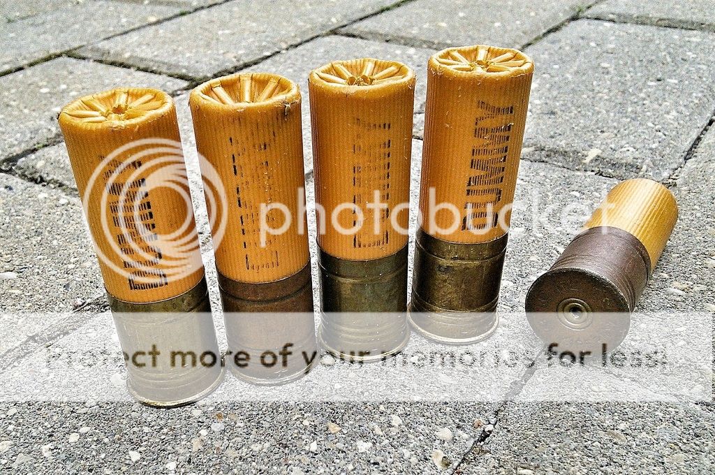

I looked for a while and tried making my own with weighted, spent hulls and silicone but was not satisfied with the feel or result.
I found these at a gun show. They're approx. 30 yrs old with little use.
So scour your next gun show for some. I buy them whenever I see them.
I just couldn't get an even cut on the hull, and didn't like the the unrealistic feel of the non crimped and folded end of the hull. Especially when practicing tactical/speed reloads.
