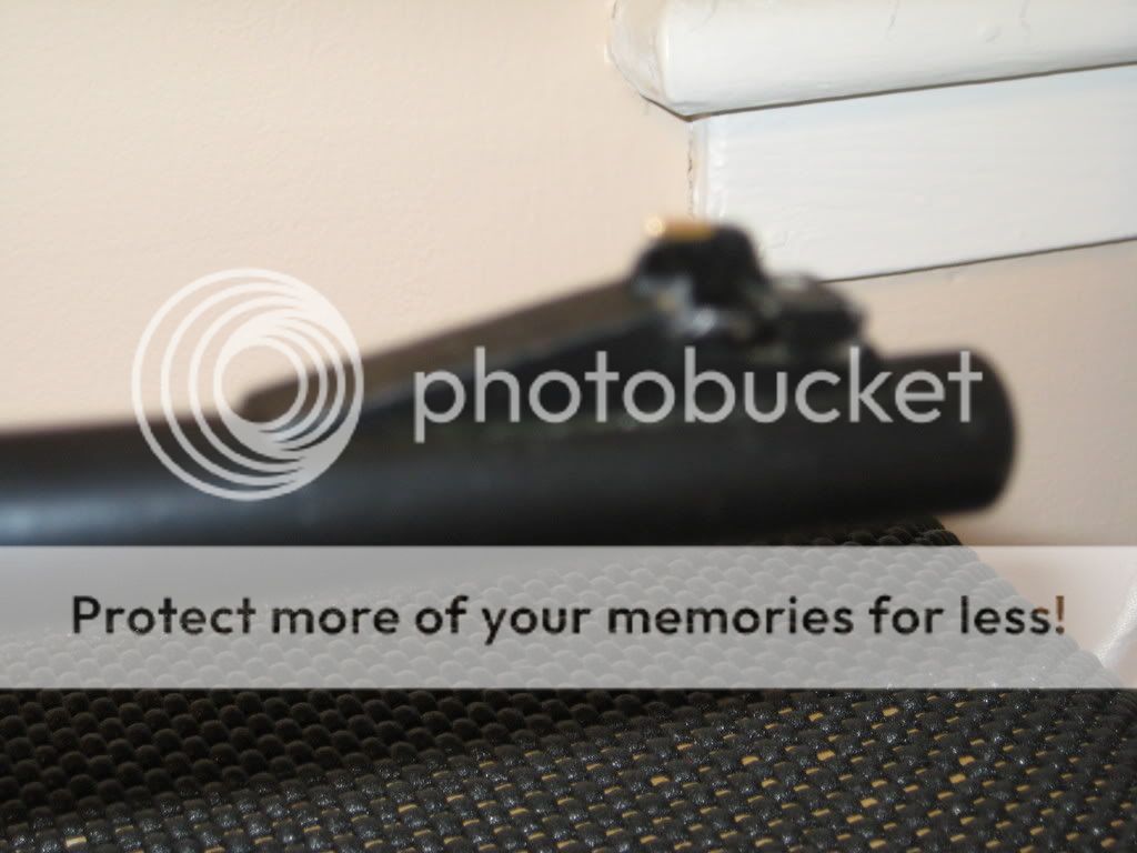

It has a lyman dovetail rear sight, front sight appears to be gold plated. It is in pristine shape and the only I added was the leather sling. The decelerator pad is original. It come with a 5 round magazine, the receiver says 303 cal. EAL 6497.I will post the pics the pics tell the story.

nice job on the checkering, and it looks like it's been polished and blued, and a different sight bead added.

The front sight bead has been exchanged from the factory original--these brass beaded sights were popular in the fifties and sixties.

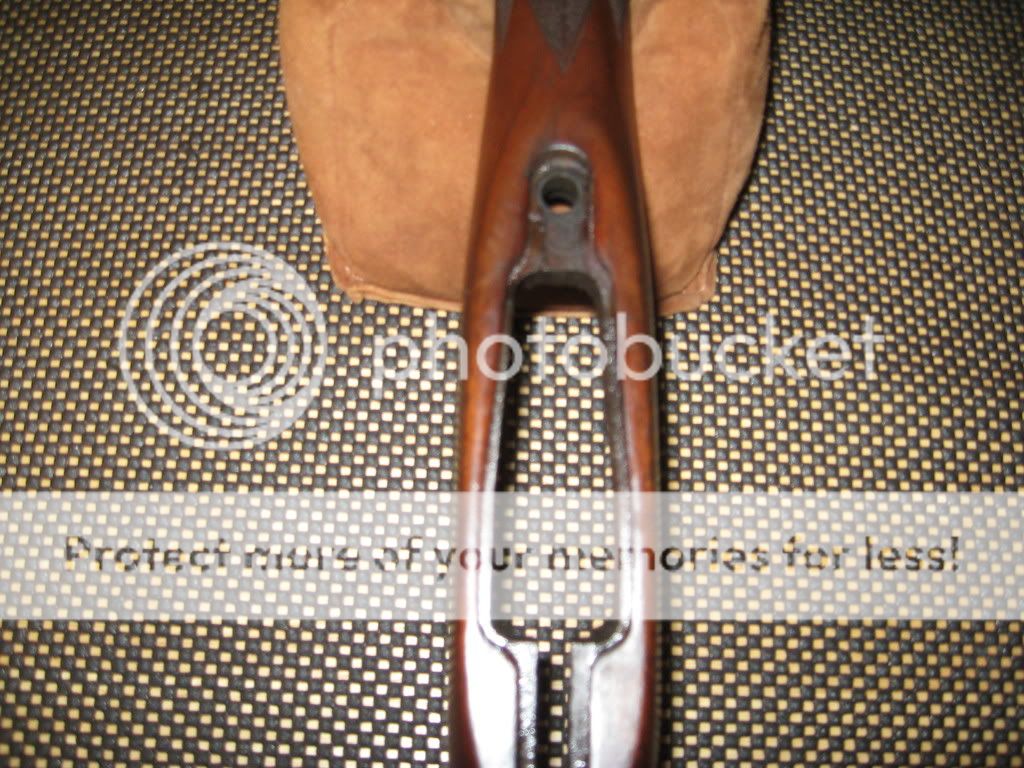

more pics as requested.
Some members have asked for more pics and have asked to to take off the front stock and take some photos. As you can see the colocur of the grain is consisten on both sides.The dark points are where the barrell touch the stock. it appears to be oil staianing fron heavy gunoil.

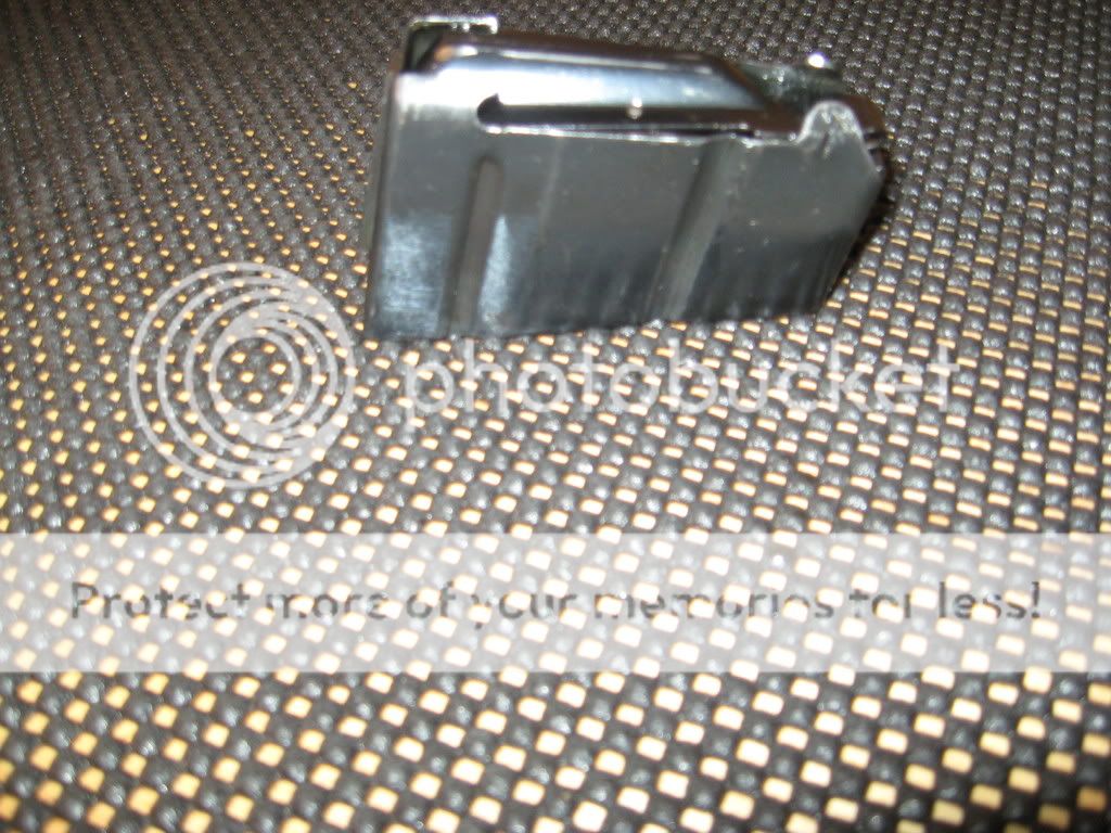

Intersting is the magazine is quite polished. It appears silver in the pics but is closer to a gun-metal grey (almost looks anodized).
I cant find any stamping or marking on the stock.
So here are the pics.
Good pics, thanks much!
Very interesting that the normal EAL front sling swivel is present, installed in the normal spot, and the Jostam buttpad. You wouldn't think a gunsmith sporterizing it would have bothered to install those would you?
Usually those sporters use the little round ball type sling swivels, I've rarely seen anyone sporterize a rifle using the sheet metal type late No 4 swivels, particularly on the forend. I've only ever seen that forend swivel on EAL's...
Does anyone think this was done by EAL? I have to wonder.

I looked at that pic of the front swivel/checkering
I have to think this rifle is a factory custom for a few reasons. First the original but pad and swivel.
Second, I understand that checkering if done at the factory, is done before they add any hardware. The checkering is clearly done well, but if you look closely at the picture the checkering is slightly off centre, what would suggest to me that the checkering was done before the swivels were added.
If the checkering was done after the swivels were put on (hence post factory) Surely any amateur would make sure centre line was lined up with the checkering.
Therefor I think this maybe the only factory custom, or the only one I know.
