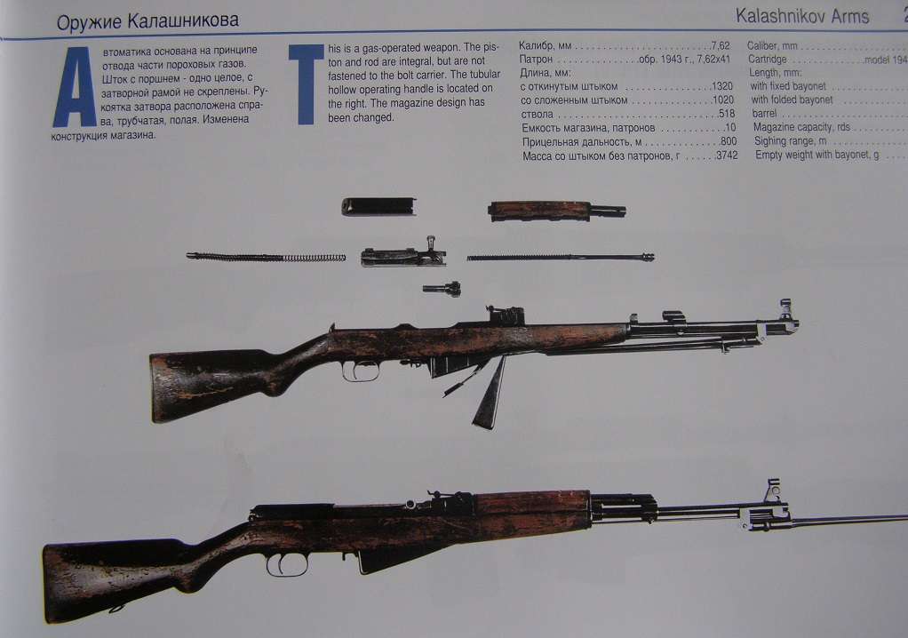

Picture of(?)SKS -43?
^Note what appears to be the bolt-head.
