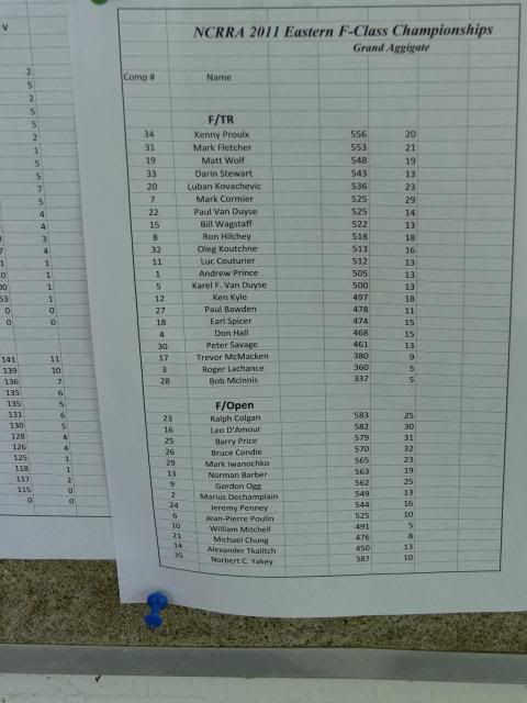

Results

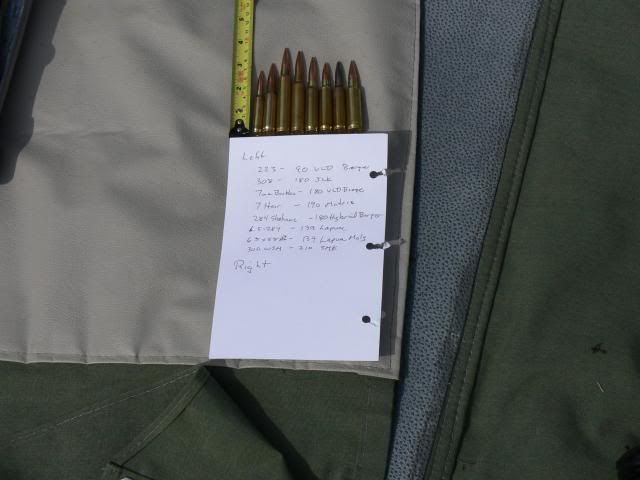

Some of cartriges used over the three day shoot

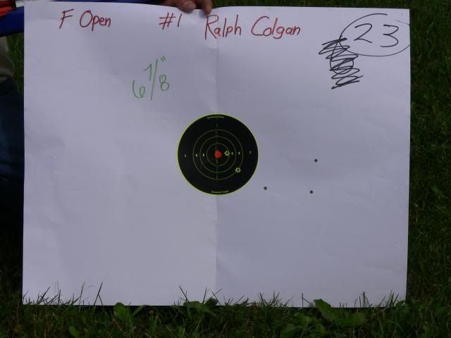

Open Class

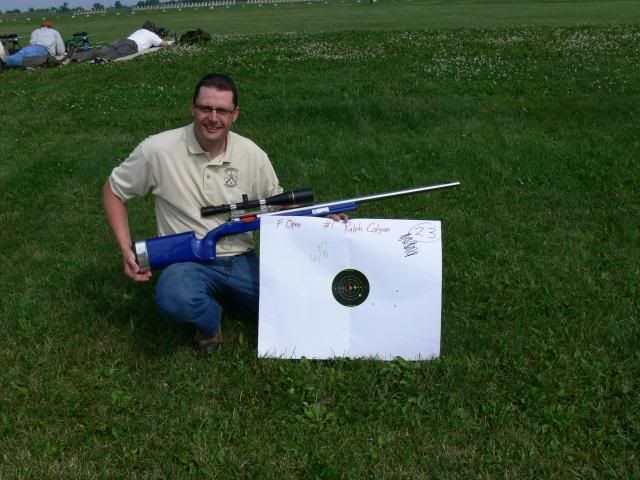

Cartridge 6.5by55 AI/ 139 Scenars Nice custom rig shooter Ralph Colgan
he also won the Open Class

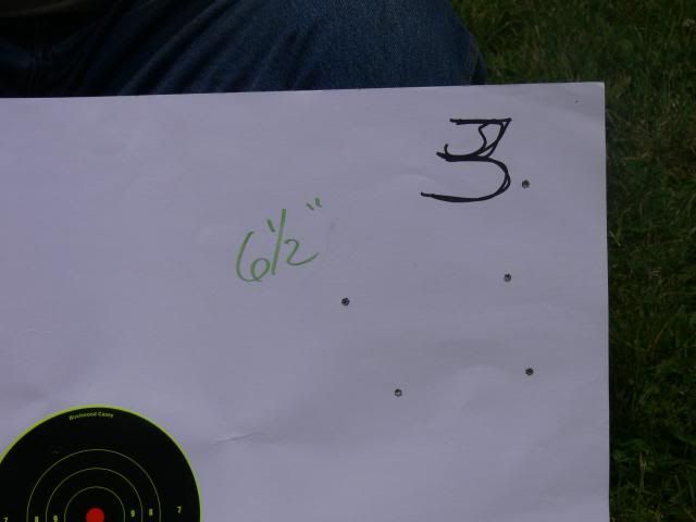

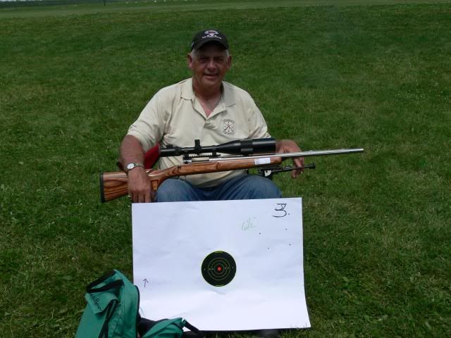

Here is quite a surprise Factory Savage 223 Rem shooting 90gr Bergers this shooter fired a nice group to end up in 3 rd place shooter Roger Lachance Ottawa ON

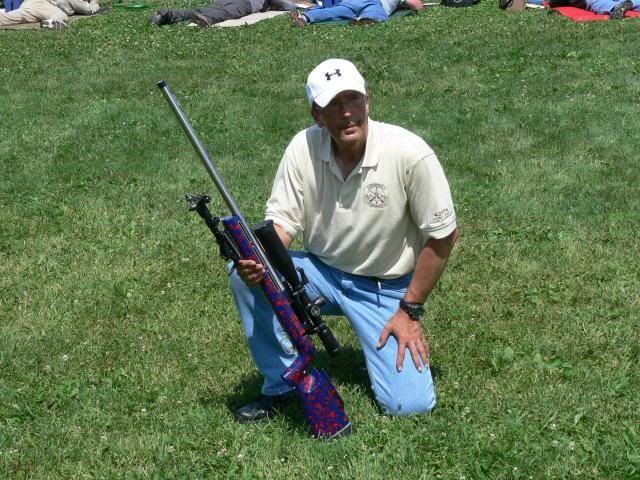

Two good friends for many years and great supporters of Target shooting in Eastern Canada Jacques Dugais on left and Leo D Amour on right Leo out shot Ralph Colgan winner of F/O in v bulls by 5 with his 6.5/284 but lost winning by one point, great shooting Leo

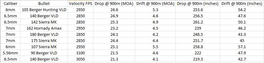

I beg to differ.... :D
6BR shooting 105's (Hunting VLD's) came within 1 point of winning the Western Canada F-Class Championship this past weekend beating out several of the 284 and its variants.
Now, when the winds really kick up it sure helps to have those heavies, but if one knows how to steer the bus it will always make it to it's intended destination.
I did some ballistic comparisons the other day just to see the deficit of my 105's against other cartridges/bullets and the 6.5 140 Berger at 3050 pretty much equal the drift performance of the 180 7mm's at 900m/1000yds while the 90gr .224 bullet at 3100 would equal the 6.5 140 Berger doing 2850.
All based on a 2000ft Zero and a 5000ft Range
