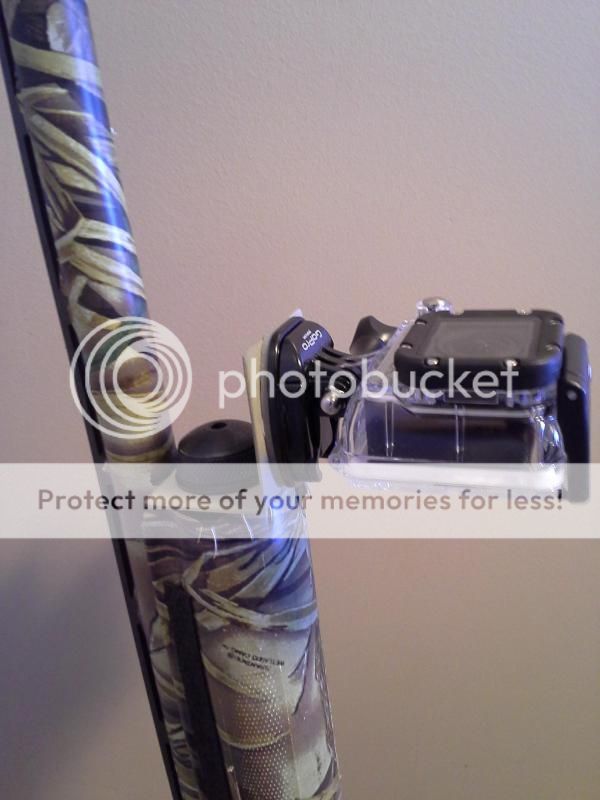

Easy gopro shotgun mount

If your shotgun has a magazine tube nut, it is a pretty simple deal to make one of these. An angle bracket and a 1" hole and you are in business.

I use the handlebar mount on my shotgun and varmint barrels, but your idea is more symmetrical to the line of sight. Nicely done!
Remember the kick back will kick the camera back no matter how tight you think it is. unless you have an extra piece to stop that.
There is a guy selling shotgun kits like this and he has something simple to stop the camera kick back. Check it it for an idea.
It's like a washer type piece you put in before screwing the gopro housing to the mount.
I know. I was gping to order the mount from them. It was $29 or something. They lost me at $26 more for shipping, so I made it myself. The other ppiece is next. :)
